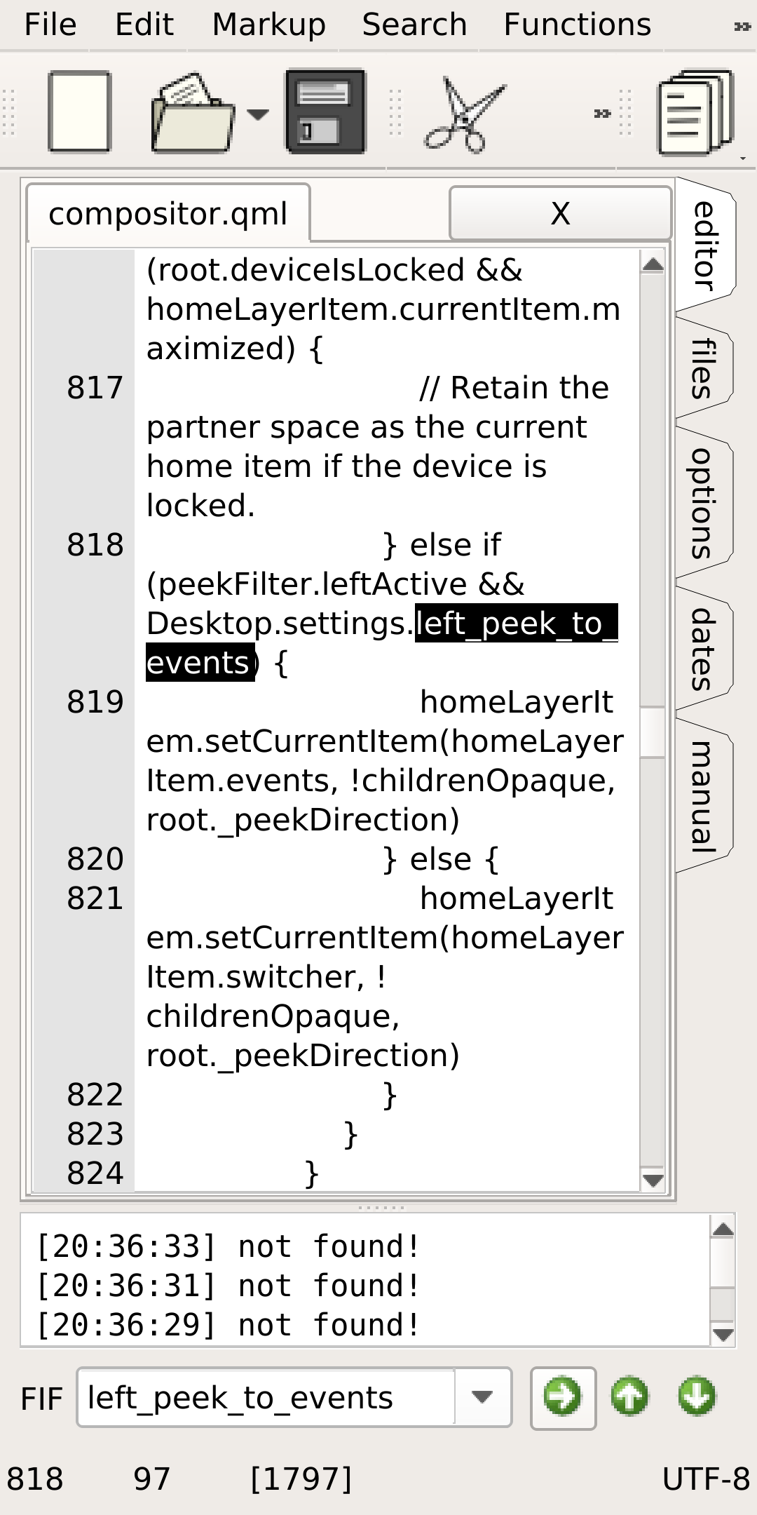

Exactly. And what I am asking for is if there is a config file where those three elements (events, app, desktop) can be reordered in the carousal. But I guess it is hardcoded in a binary somewhere.
I’ve dug around in qml and dconf files, and I don’t see anything… I think you’re right… Although I think technically you coul edit it somewhere, because it’s a file somewhere that dconf is reading, but probably (yet another) closed-source SF thing
(it’s called “left_peek_to_events”)
Maybe one can just switch the calls made inside the else if and else scopes. I might try that when I’m back from vacation. Thanks for finding it.
Perhaps it is enough to just switch the eventsLayer and homeLayer aliases near the top of this file.
Likely, because it is part of the Lipstick UI (the equivalent to the “Desktop Environment” on desktop Linuxes), but this is all QML code (i.e., interpreted JavaScript code), which is easily patchable. If one found a way to patch this it can be packaged as a Patch for Patchmanager and be distributed for all.
