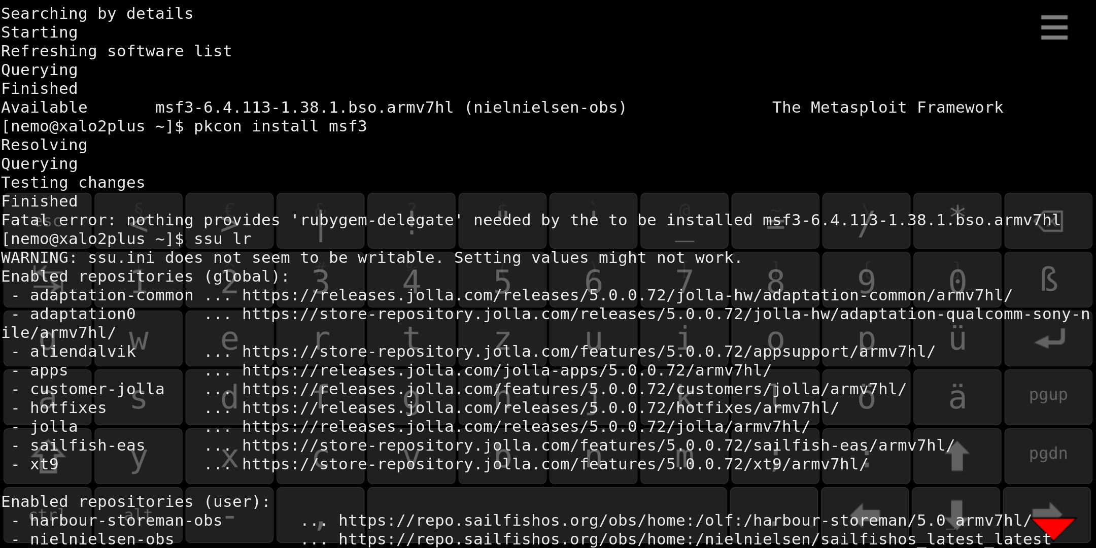

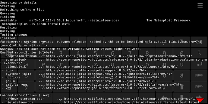

Hei Niel,
out of curiosity I wanted to play with msf,
but get this error about missing rubygem-delegate on installing after having added your OBS repo.
Aaah thank you. I had some bad Requires in the RPM spec.
Should be fixed now :slight_smile: (building as I write)
