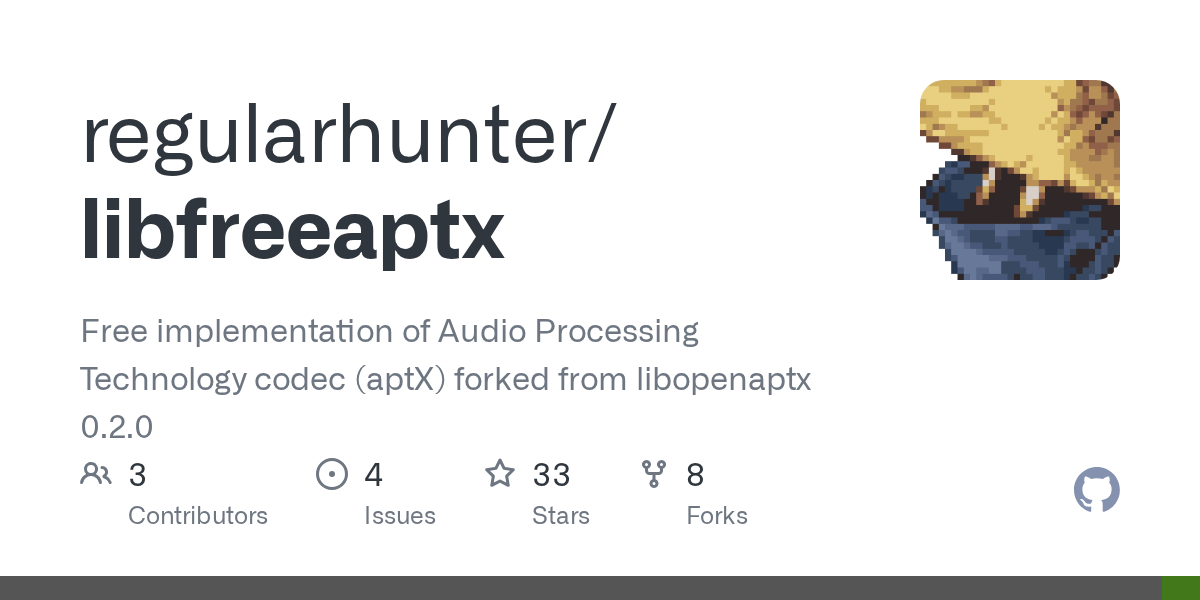

Sorry it took so long. It’s not working and I had to do some detective work. First off, you don’t need to replace all of pulseaudio, just /usr/lib64/pulse-17.0/modules/libbluez5-util.so. Second, there’s neither AptX nor LDAC support in gstreamer, which is why it’s not showing up for me at least. Both should be in gst-plugins-bad but they depend on libfreeaptx/libopenaptx and libldacBT-enc respectively. The resultant libraries would be /usr/lib64/gstreamer-1.0/libgstopenaptx.so and libgstldac.so which are conspicuously missing.
These are the libs gentoo would use:
So I guess we’re gonna need those packaged first, and then rebuild gstreamer1.0-plugins-bad

@nephros you beautiful bastard you already packaged freeaptx and ldacBT
if @poetaster or @attah wants to run a build of gst-plugins-bad with -Dldac=enabled -Dopenaptx=enabled then we’re there for A2DP.

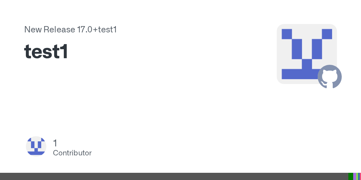

Attah’s build of pulseaudio with gstreamer-bluez5 enabled, however all you need from the rpm is /usr/lib64/pulse-17.0/modules/libbluez5-util.so
Edit, somehow managed to forget to link it: Release test1 · attah/sailfish-pulseaudio · GitHub
