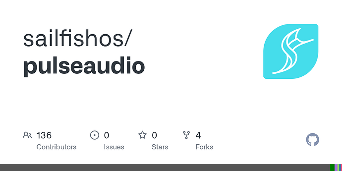

I wonder if there is any prospect of PA 15 arriving for this?
they have a PA 17 pull request from over a year ago, but still didn’t pull it yet.
There is always an open pull requests topic during the community meeting. You can raise it there.
No reason for that. They will do it when they want. My questioning won’t help.

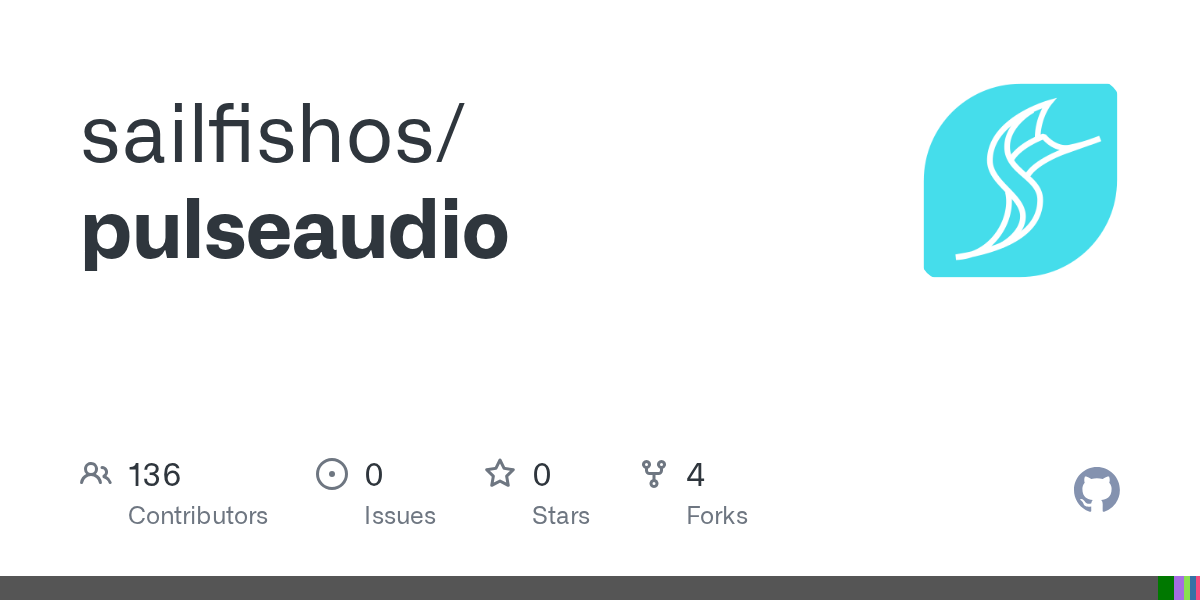

The related option is disabled here:
I don’t know why - but when we have 5.1 build targets available, it might be doable to enable and try to build - and see what fails.
