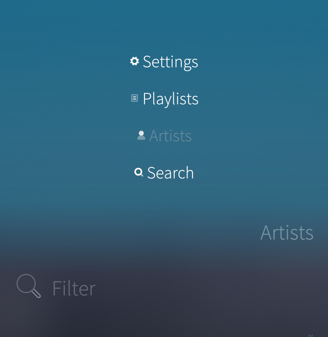

One difference I see in the recently compiled Subsoniq on ohnonot’s webserver and chum:testing, that the emblems next to the page names in the pulley menu are missing.
(screenshot taken on a build I compiled from commit 6e67baede9 on April 23rd)
Was that an intentional change?
No, clearly not intentional. I guess the migration to cmake broke the resources path, need to fix that. Thanks for reporting.
