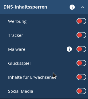

So I tested it on my PC and disabled all DNS blocking capabilities of the VPN client (Advertising, Tracker, Malware, Gambling, Adult Content and Social Media). Originally, I had all of them turned on and then turned them off one by one and tested the connection with the ping command, until everything was disabled.
Every try, pinging storeman.net didn’t work, giving either ping: storeman.net: System error or ping: ``storeman.net``: Name or service not known
But when I disconnect from VPN, I can ping it just fine.
And I doubt that the default configuration of the VPN blocks some links (wouldn’t really make sense, would it?)

The thing is: I don’t have any blocking apps installed as far as I’m aware of. I have only some DNS blocking activated for my VPN but as I posted earlier, even with those disabled it doesn’t work.
This unfortunately didn’t work for me
Try to switch all of them off at once. A blocked domain can be in two or more categories.
I already tried - didn’t work.
