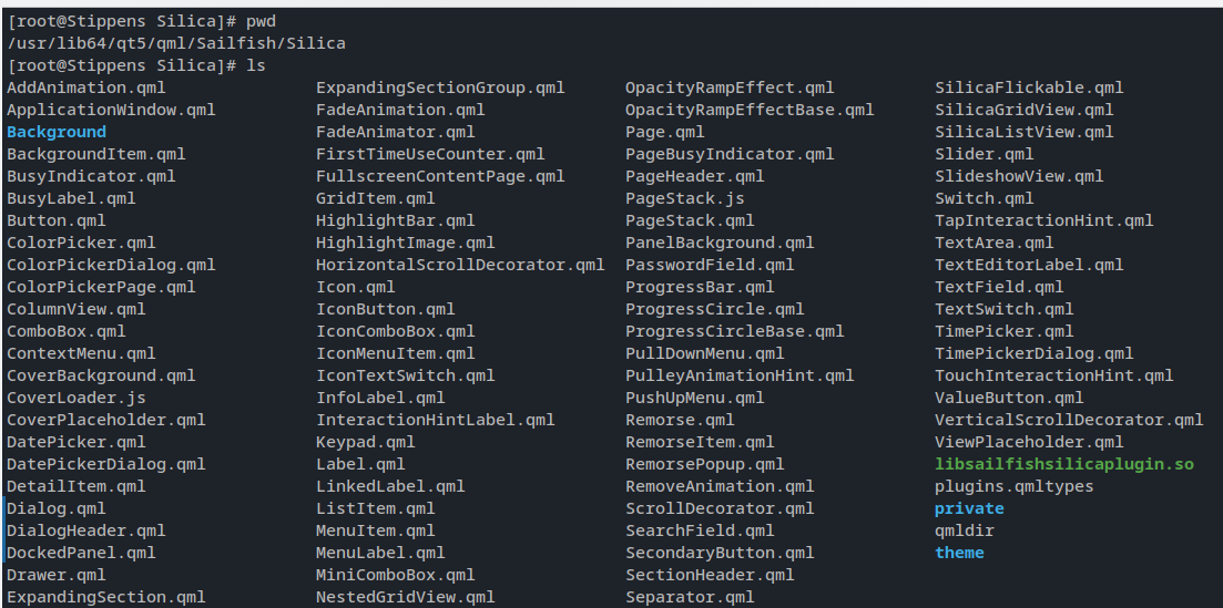

The /usr/lib/ paths surely differ on 64 bit devices, unfortunately I don’t own one. Therefore paths still from 32 bit device - sorry for this.
First make backups of all original files:
Do this only once, repeating it later would overwrite the original backup file!
Commands on the list are ready to copy and paste.

/usr/lib/qt5/qml/Sailfish/Silica/ :

/usr/lib/qt5/qml/Sailfish/Silica/*------------------------------------
vi /usr/lib/qt5/qml/Sailfish/Silica/AddAnimation.qml

I wanted to try your adaptation. Unfortunately, my launcher is now empty. No more apps there.
I have copied back all the backups (.bak) of the files and restarted my 10III. But the launcher is still empty. Any idea what the problem could be?
My only idea at the moment is, that I maybe forgot one file on the first list. I’ll check as soon as I’m at home again.
Did one or more Undo command find no backup when restoring original file?
Other idea (but only guessing) is, that the whole software structure on 64 bit devices may differ more than expected from old Xperia 10.
How is the /usr/lib/ path on your 10 III?
Really simply /usr/lib64/ and for the rest no difference? Does a /usr/lib without 64 still exist on the 10 III?
Unfortunately I don’t have a 10 III, so can’t check.
I reinstalled lipstick-jolla-home-qt5 with zypper. Now everything is back.
I compared the backup files list with the second list ā€œvi /ā€¦ā€. They were all there. There were even a few files in the backup commands that were not changed. If I was not mistaken … so many lines.
To the 10III, the first three blocks when creating the backup files do not find the target. I did not search for or change the files. It must have been my mistake.
/usr/lib still exists, /usr/lib64 too.
The screenshot shows the contents of /usr/lib64/qml/Sailfish/Silica.
