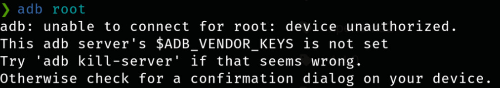

According to the wiki, I should change to adb root after restarting to recovery. However I can only do it before that. In recovery it goes like this:
Okay, there is “Enable adb” option in Advanced that enables adb root directly.
Other than that, seems to install and works! Thanks a ton!
Thank you very much for going through it! I have added it to the wiki.
Not sure about the adb root step after enabling it in Advanced - it maybe is needed it if you didn’t run adb root in Android before restarting to recovery, but if you did - it shouldn’t be (probably, at least it wasn’t for me). Probably because the adb root is a flag of adb that switches the PC server in that mode and if you restart the device, it still stays in that mode.
