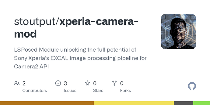

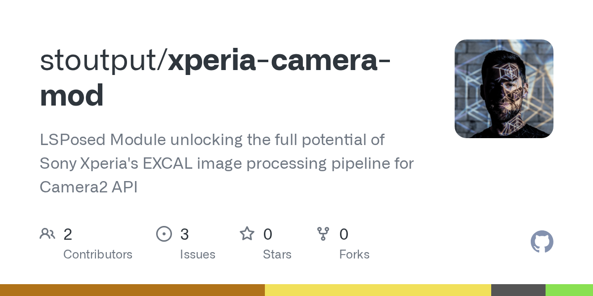

Hey, folks. I know this is made for Android, but could something like this be beneficial to SFOS as well?

That will probably be a nice addition to gstreamer quirks for camera, whenever camera2 API is possible in the future, but it sounds like a lot of params to test and some need camera HUD changes, so I wouldn’t think more than some defaults tweaked for everyone would be doable even then. But thanks for the link, now the back of my mind is even heavier ;p
