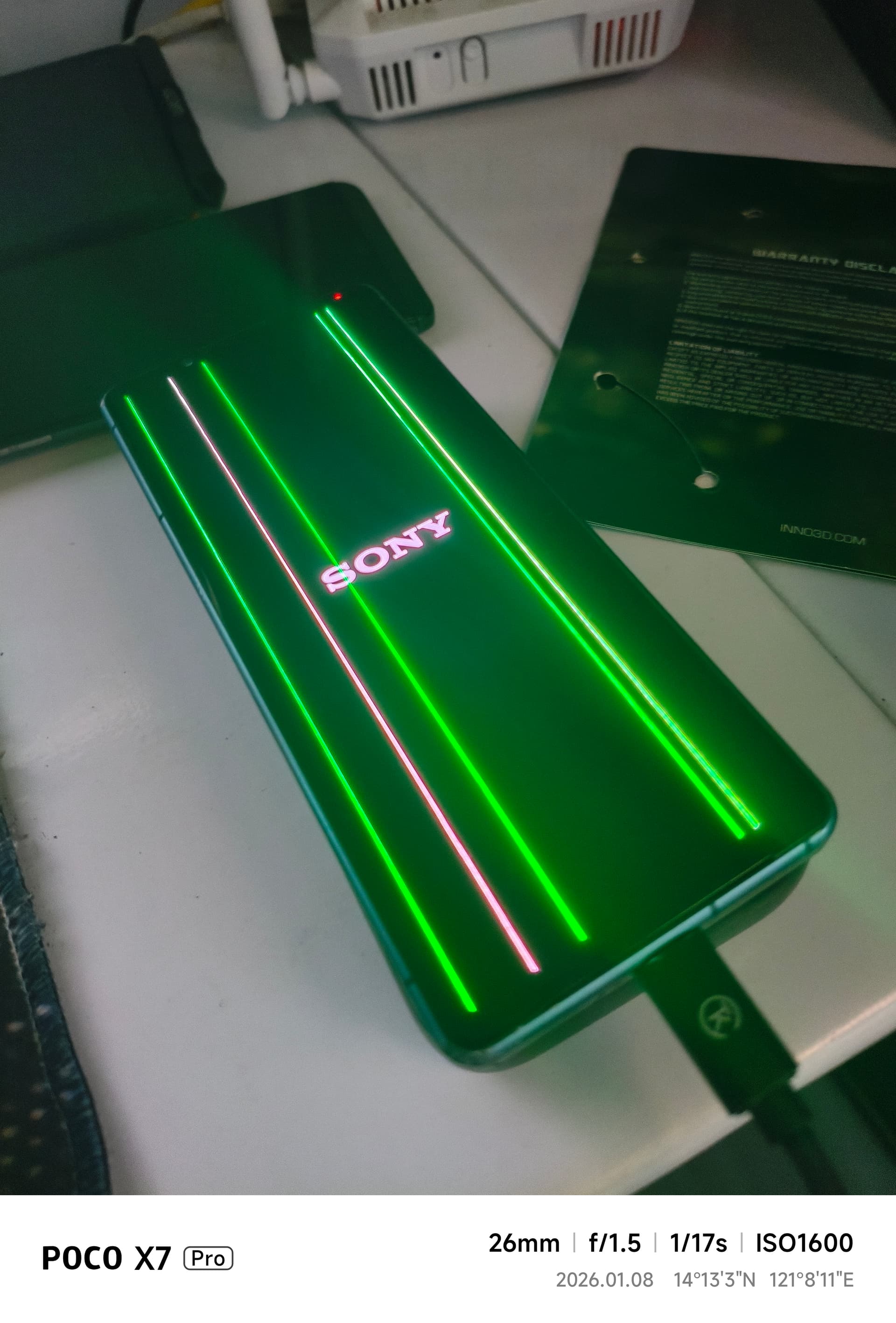

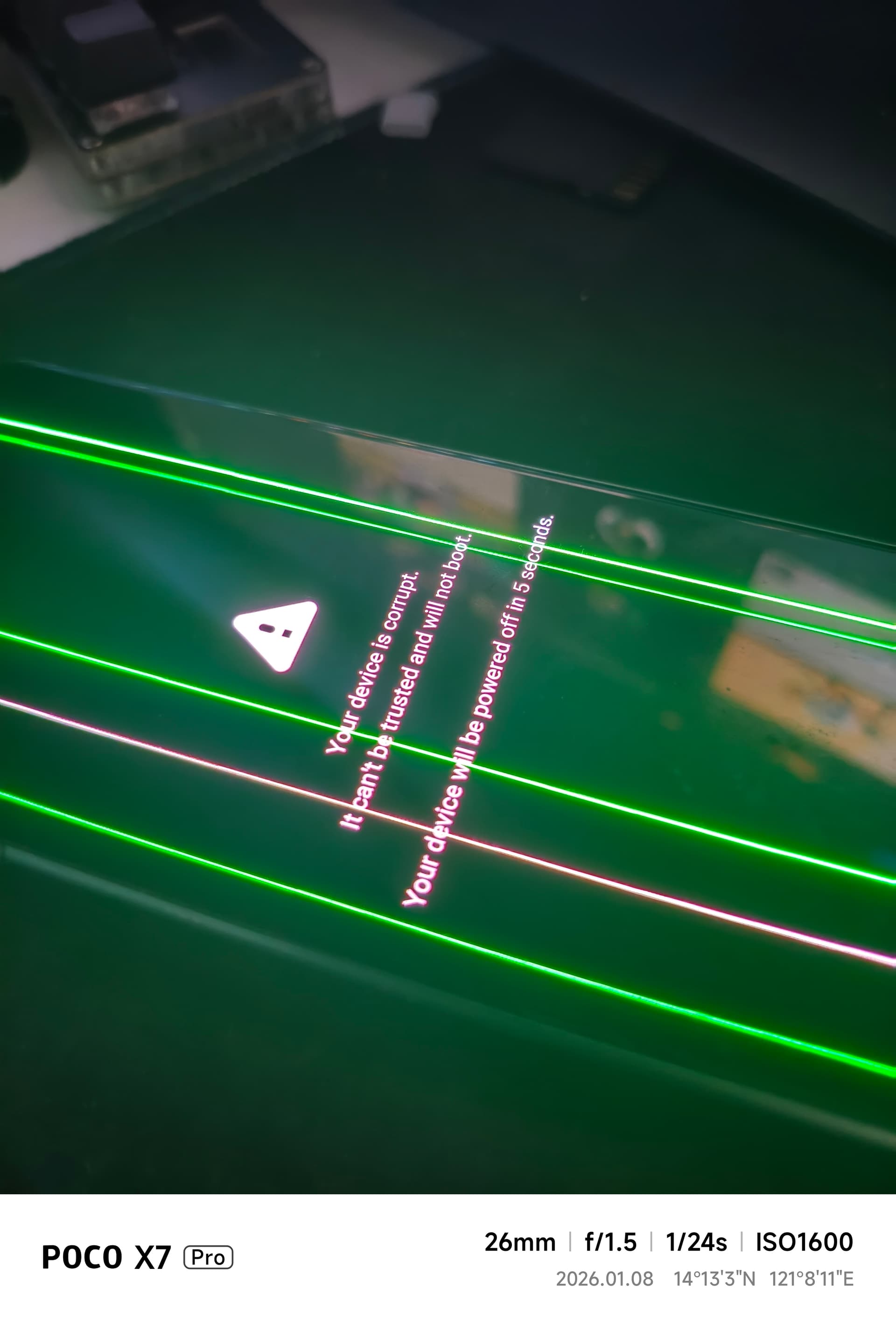

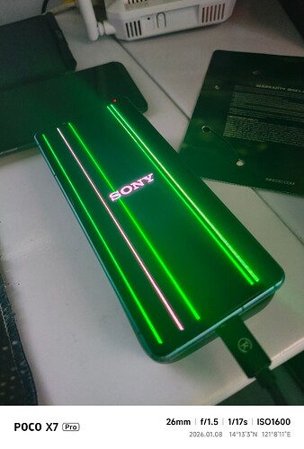

did the slots thing and still the same issue with it being stuck on the sony logo. (ignore the green lines, it aint my main phone anymore :skull:)

When looking closer in the path of flashed files, looks like you have the same vendor_boot for LOS and SFOS. It seems that you unpacked LOS and SFOS images into the same folder and due to the same image file one overwritten another one.
Please unpack LOS and SFOS archives into separate folders and flash making sure that the files are correct.

A few posts above there’s a video and pictures from @Zebastian with those green lines. Looks horrible :frowning: I’ve read that it’s caused by excessive heat - something inside the display gets disconnected.
