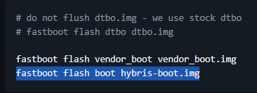

Hello! I have a problem with my Xperia 5 IV (XQ-CQ72 Taiwan) where it will boot fine on lineageos however as soon as I try to flash sailfish os using the guide on the wiki, it gets stuck on the sony logo. I left it for about 10 minutes and its still stuck.
  • I resetted lineageos before i flashed sailfish os.
  • I tried the stock and theother dtbo img (that i wasnt suppose to use but heck i tried both and none worked)
    I reflashed it multiple times and I also reboot multiple times and nothing…

do i flash the dtbo img or no cause it says on the guide that I shouldn’t…

Re dtbo: DTBO from stock should work just fine - no need to flash it.
