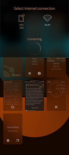

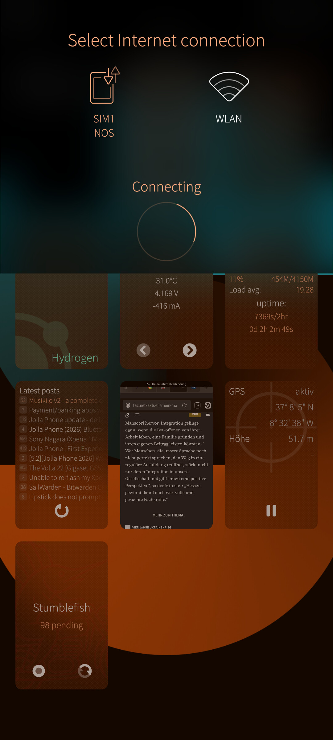

When leaving flight mode the phone cannot reconnect to previously connected WLAN or used mobile networks. Also in system / utilities the network and mobile reconnect utility does not help to reestablish connection. When using the toggle for mobile or WLAN the spinning circle appears and continues without establishing a connection.
Reconnection to networks (WLAN and mobile) only after reboot.
Phone is put into flight mode and the toggle is put to off to leave flight mode and re-enable network connection
  1. Enter flighmode
  2. Leave flightmode
  3. Optionally: toggle off and on again network after leaving flight mode

No connection to networks possible, neither WLAN nor mobile
