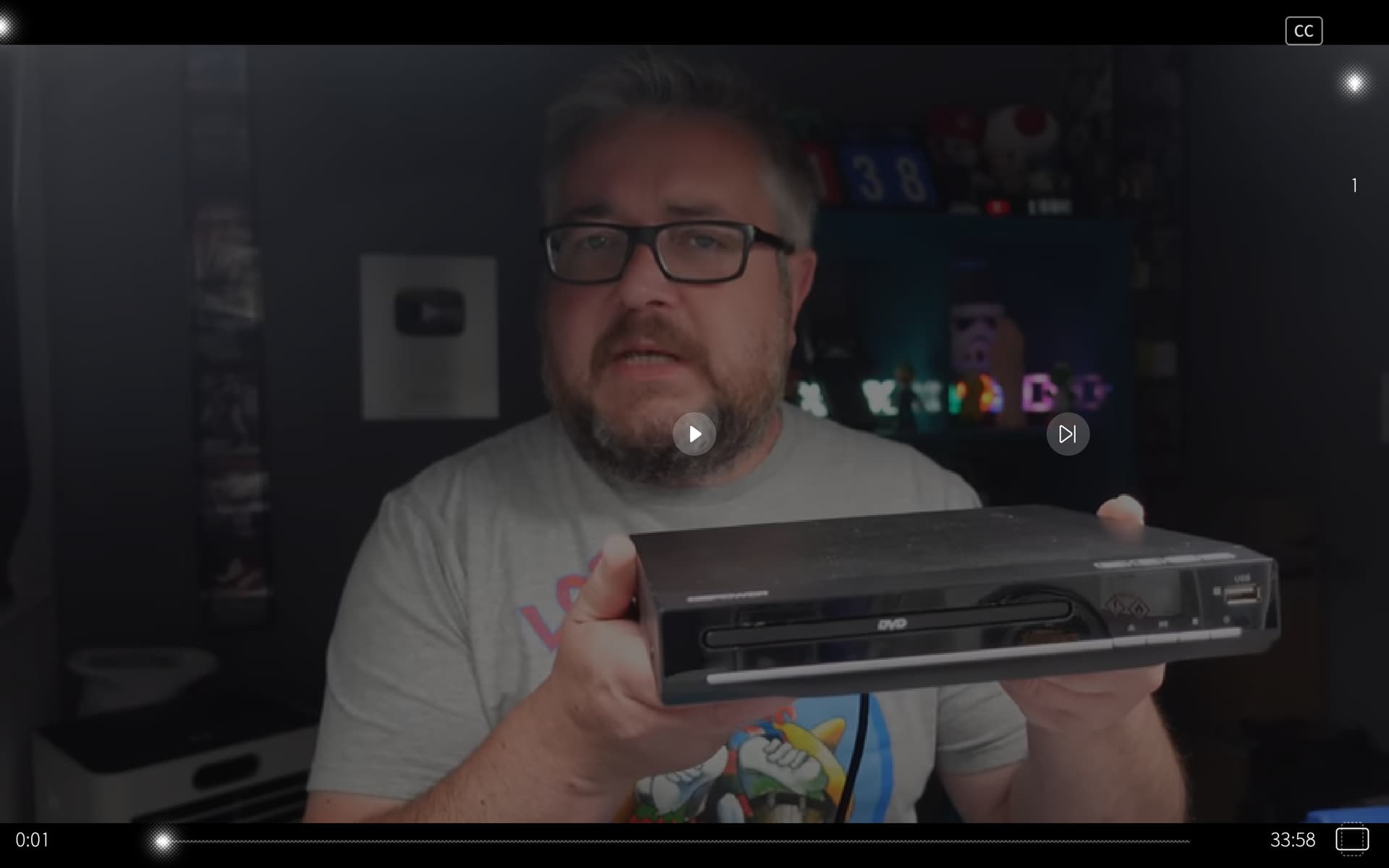

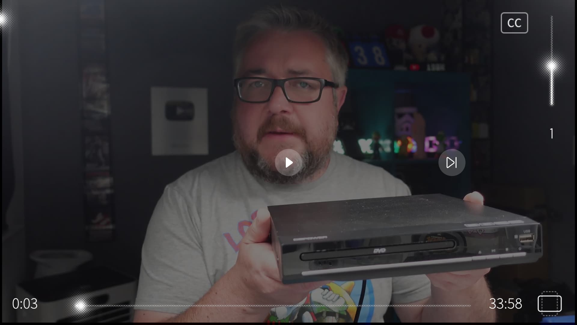

Also in case you even dare to think “ah its just magister with his imaginary issue”. Same app. Tablet vs phone
Now imagine just for a second, imagine we used thing that actually scales with pixel ratio like Theme.paddingLarge*3
Wow! They both look good now! How could it be! Magic!

So I guess you’re talking about the vertical slider on top right corner? Suppose that’s the Slider with some rotation?
