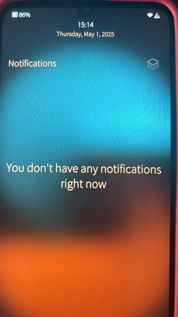

I am attaching a picture under “Connectivity” , “Cellular network”.
The white dot on the left side of 4G calling (VoLTE) is blinking.

Here is a picture of the settings screen as well.
