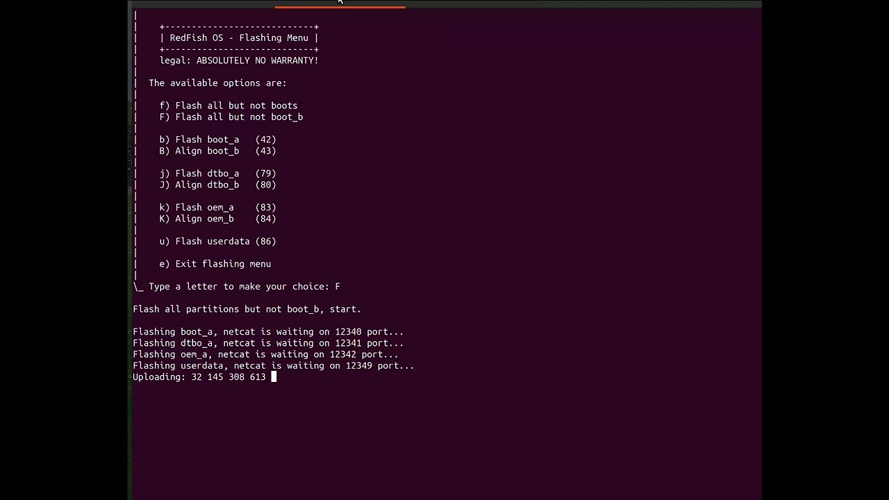

UPDATE #17
Now, it takes 55 seconds to flash the userdata partition with the SFOS 4.5.0.21 spare image.
Moreover, flashing all the partitions as flash.sh script does, boot_a, dtbo_a, dtbo_b, oem_a, oem_b and userdata using the RFOS recovery image with a single command takes 54 seconds — as long as the longer flashing procedure among all involved because the RFOS image can operate in parallel but not the fastboot command.
The menu above is more updated than the one used in the video below.
Flash all partitions but not boot_b, start.
Flashing boot_a, netcat is waiting on 12340 port...
Flashing dtbo_a, netcat is waiting on 12341 port...
Flashing oem_a, netcat is waiting on 12342 port...
Flashing userdata, netcat is waiting on 12349 port...
Uploading: 25 221 677 1180 1602
Writing: wr wr wr wr wr wr
Flash userdata completed in 52.451s
Flashing userdata by netcat/simg2img done.
flushing /dev/mmcblk0p86: ok
28860416 bytes (27.5MB) copied, 3.101750 seconds, 8.9MB/s
flushing /dev/mmcblk0p42: ok
279063 bytes (272.5KB) copied, 3.159021 seconds, 86.3KB/s
25165824 bytes (24.0MB) copied, 0.289088 seconds, 83.0MB/s
flushing /dev/mmcblk0p79: ok
flushing /dev/mmcblk0p80: ok
419430400 bytes (400.0MB) copied, 11.970527 seconds, 33.4MB/s
419430400 bytes (400.0MB) copied, 4.078934 seconds, 98.1MB/s
flushing /dev/mmcblk0p83: ok
flushing /dev/mmcblk0p84: ok
Flash all completed in 54.514s.
After having flashed the userdata partition, it is possible to prepare it for being used by SFOS and the default root partition size is no longer 5GB but 8GB.

The developers menu
Instead of making longer and longer the main menu, I split it in few specialized sections:
I also moved the rootfs options to developers menu just to keep it short enough.
