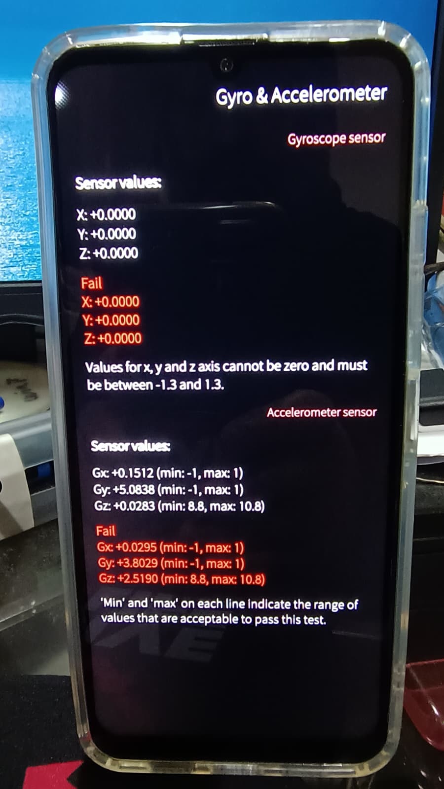

Yep, gyroscope and accelerometer does not work at all

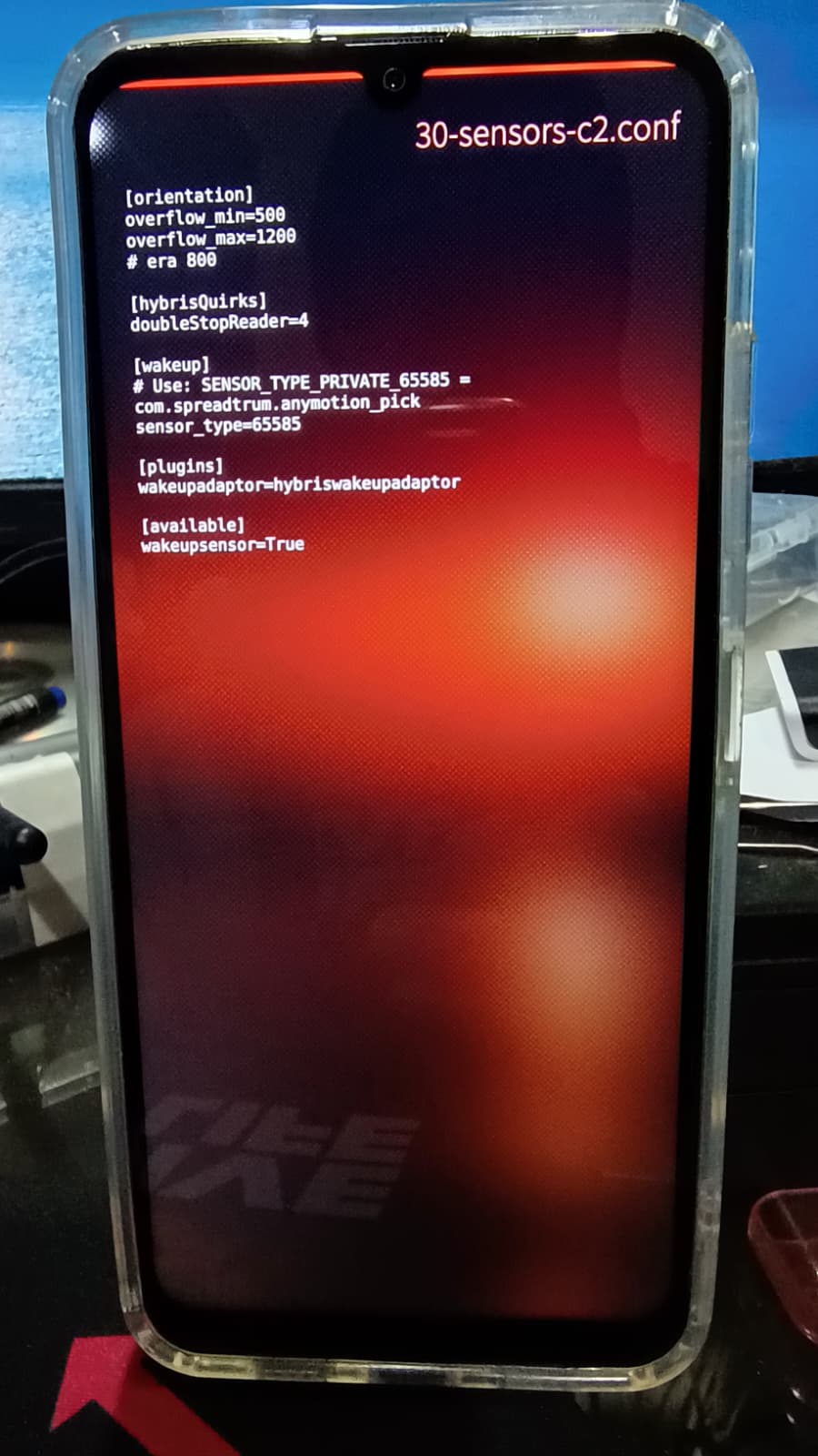

My C2 is also having issues with the sensors and GPS. As promised, here is a description of how I fixed the accelerometer.
To rotate the screen, I changed the threshold from 800 to 500 in the 30-sensors-c2.conf configuration file – see photo…

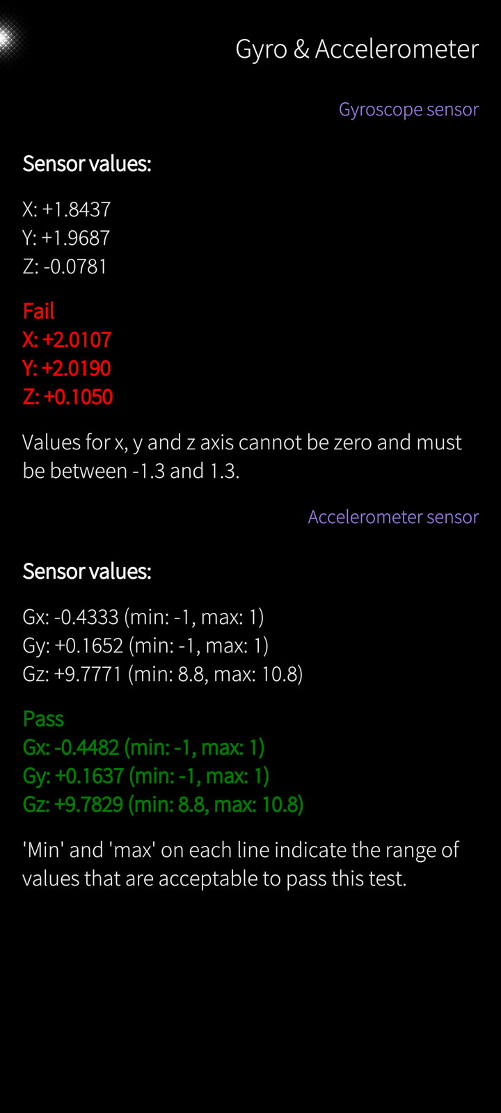

I did this because in the CSD tool, the axis reading never exceeds 600 counts when I rotate the phone (while stationary, of course).
I’d like to know if these values are the same on your C2s, especially on those where the GPS isn’t working (I want to see if there’s a connection).
I’ve checked on a Sony XA2 and found that these values easily exceed 900 counts…

Could you take the same photos, or could you describe how your C2 behaves?

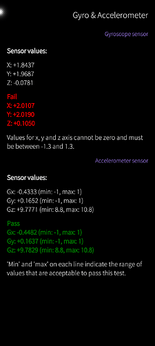

Your gyro seems dead. But IIRC it doesn’t work properly on any C2. So no big loss.
As you can see above it seems that accelerometer on mine seems to work properly. I suspect HW on your C2.

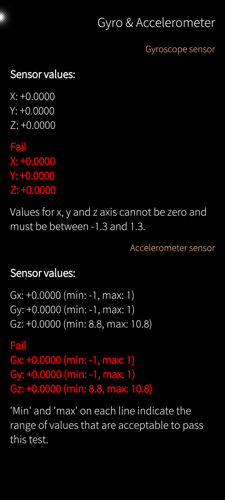

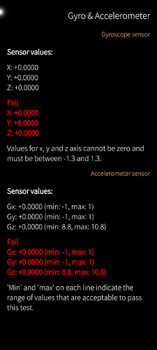

Unfortunately “systemctl restart sensorfwd“ does not help in my case. Other sensor tests in CSD like light sensor and proximity sensor are ok, gyro&accelerometer and compass fails

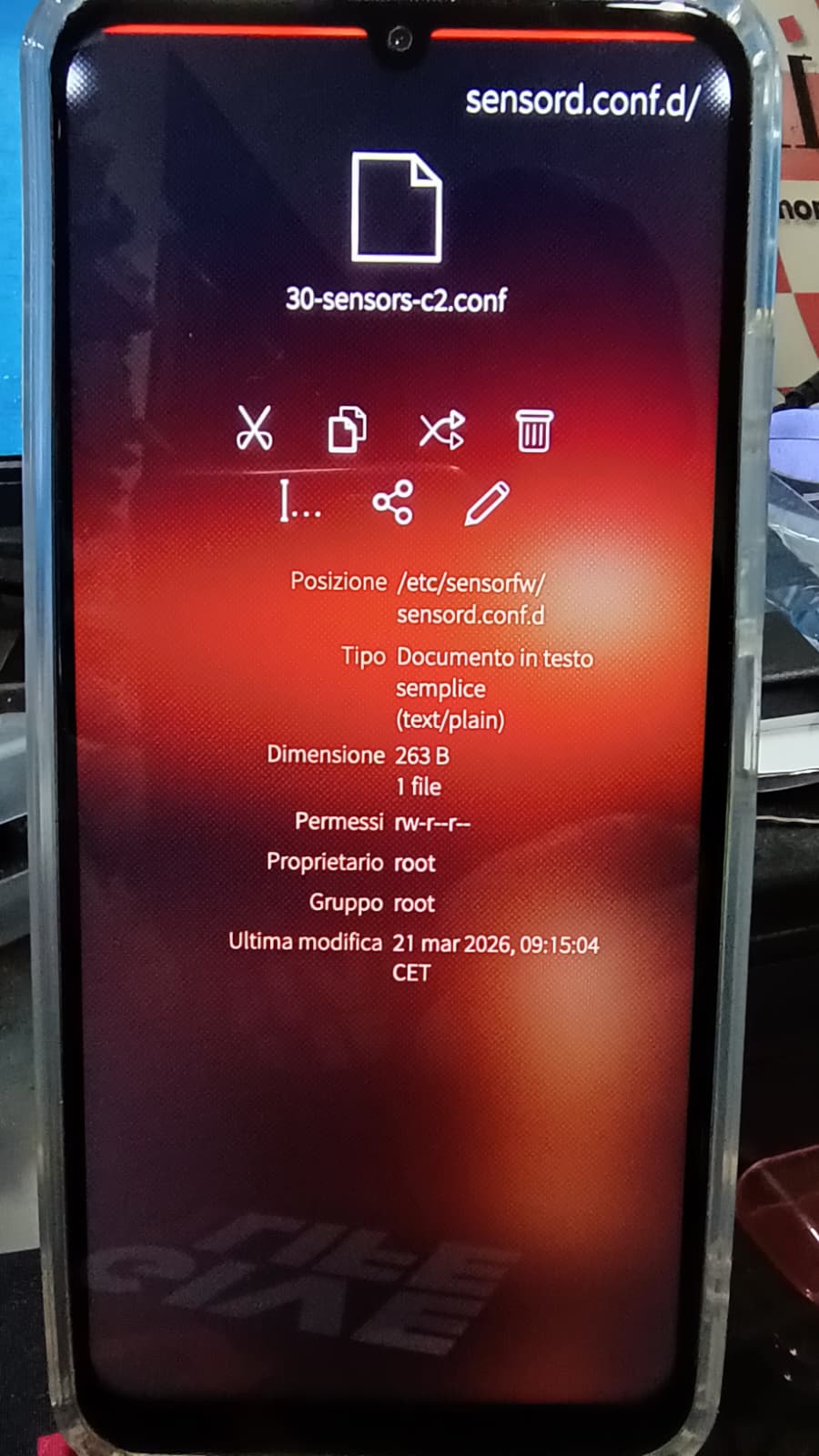

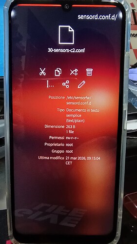

Here my screen of the test result, while the file you mention in my telephone exists but it’s blank (I found it using ssh through linux, the file manager cannot see it I don’t know why)
Maybe worth a reflash.
If file is still empty or both senzor outs sill zero there’s something wrong with HW I guess.
