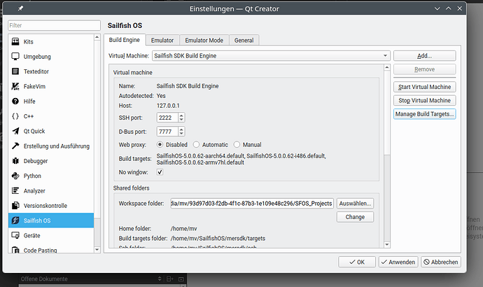

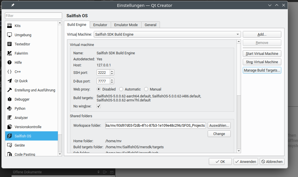

I did install the sdk about a week ago (on linux), used most of the default settings. Also had some issues but after messing around with settings a little I finally got it working.

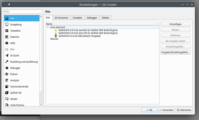

Sorry for not really helpful (cant remember exactly the issues and what solved them) but try to add the kits and set i486 as default and try to run the build engine and the emulator
edit:

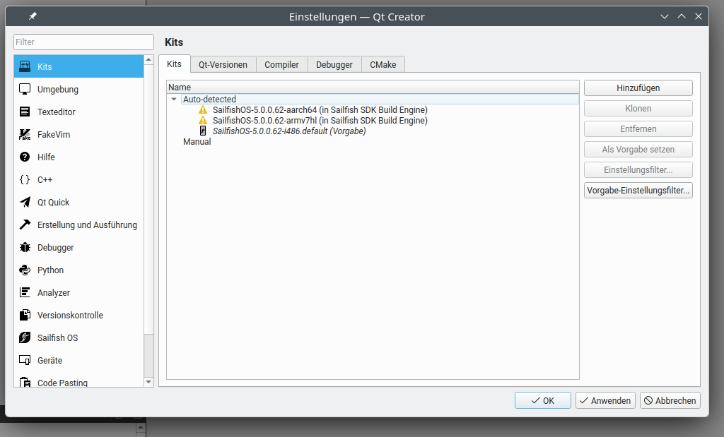

so far i remember I had some issues with kits
(the exclamtion mark for armv7 and 64 is there because I havent added a device yet but this is not needed to build)

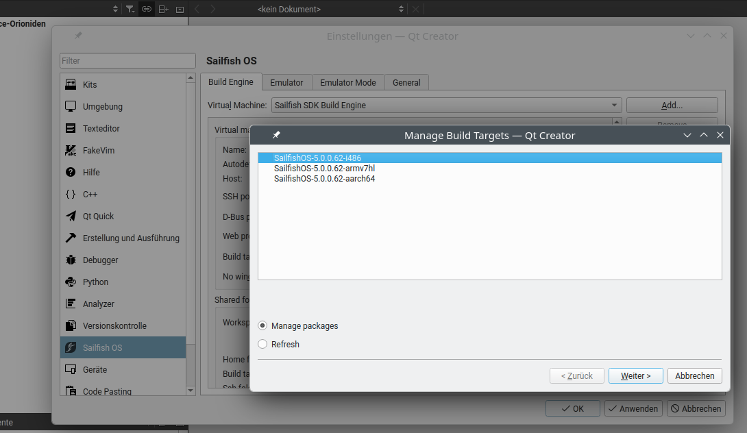

also afaik at first manage build target was empty (cant remember what fixed it)

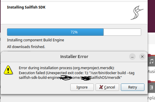

This is the error, when selecting docker from installation option (when trying to install on Linux). Installation seemed to be successful when selecting the virtual box option.
I use virtualbox version, cant say much about docker one
