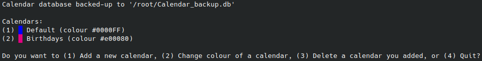

I’ve created a small script to allow you to easily add new calendars to SailfishOS:
AddCalendars.zip
It must be run from the terminal as root, because it directly modifies the Calendar database. Here is what it looks like:
[defaultuser@MyPhone ~]$ devel-su
Password:
[root@MyPhone ~]# ./AddCalendars.py
After making any changes, you will need to close the Calendar app. When you restart it, the new calendars will be available.
For some reason, all newly added calendars are called “Personal”, but underneath it shows their description - which I’ve set to the name you chose. I suspect it’s called “Personal” due to the value of the Flags field I’ve set, but unfortunately this seems to be undocumented, so I had to use the value that someone else said to use.
Each time you run the script, it backs-up the current Calendar database to “/root/Calendar_backup.db”, although I don’t expect any problems, because it first checks the database’s structure looks right. But if you DO have any serious Calendar problems, please do NOT run the script again until you have renamed the backup file (so it doesn’t get overwritten).
  • = Unfortunately SfOS’s built-in terminal doesn’t handle 24-bit ANSI colour codes, so you won’t see any coloured squares in that case. But I find it easier to SSH into the phone from my PC for stuff like this, and so in that case the colours are visible.
