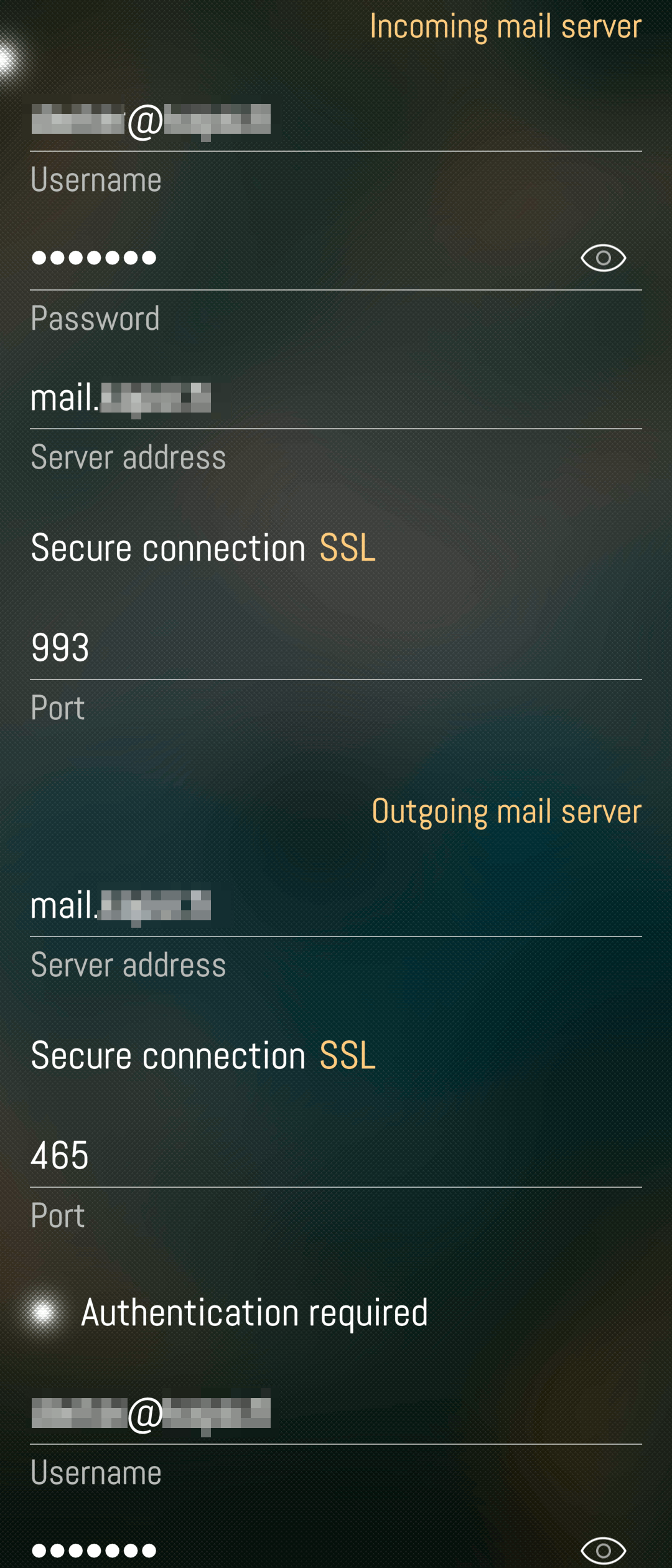

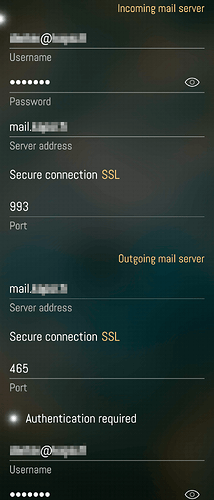

FWIW, my server settings look like this, but it’s all specific to your email provider!
I have pretty much “same” settings like @ohnonot does.
