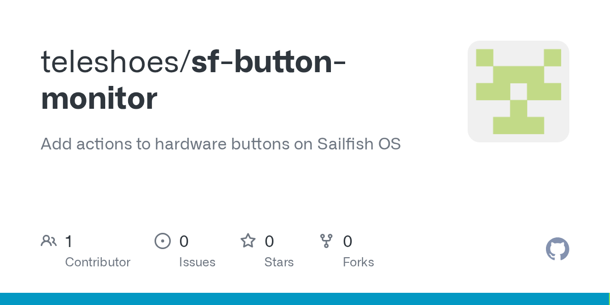

There’s got to be a way to make this easier on us. Did you post your script somewhere for the double tap pkill? or maybe we need a Nofono app for Msg-Engine .. hm…
cool. my script for the button shortcuts:
its just a single perl script and you have to run it as root since it reads raw input. the config file is fairly straightforward to make. i never got around to wrapping the script in a user friendly app. (also, if you run it with keepalive-tool it will work while the screen is locked. keepalive will also drain about ~4% more battery per day, at least on my 10III)
i use sfbm for a billion things, like restarting ofono, restarting pulse-audio, restarting mms-engine, restarting appsupport, restarting bluetooth, restarting the camera server (it occurs to me that sailfish basically doesnt work), and also toggling the torch and pause/next/prev mediaplayer.
