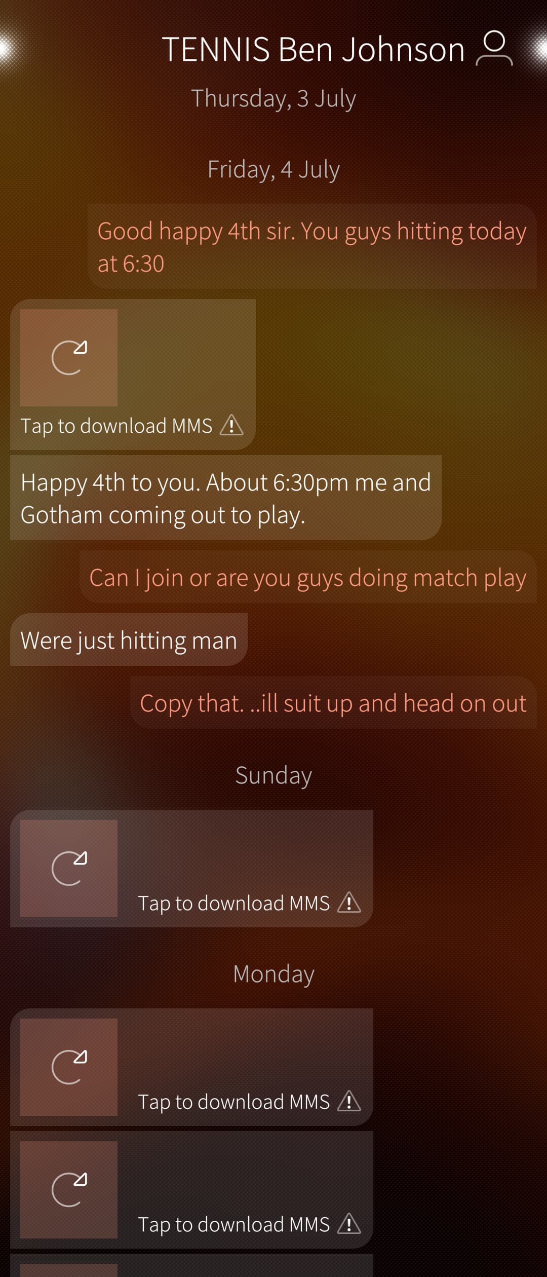

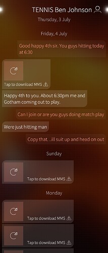

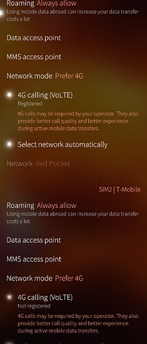

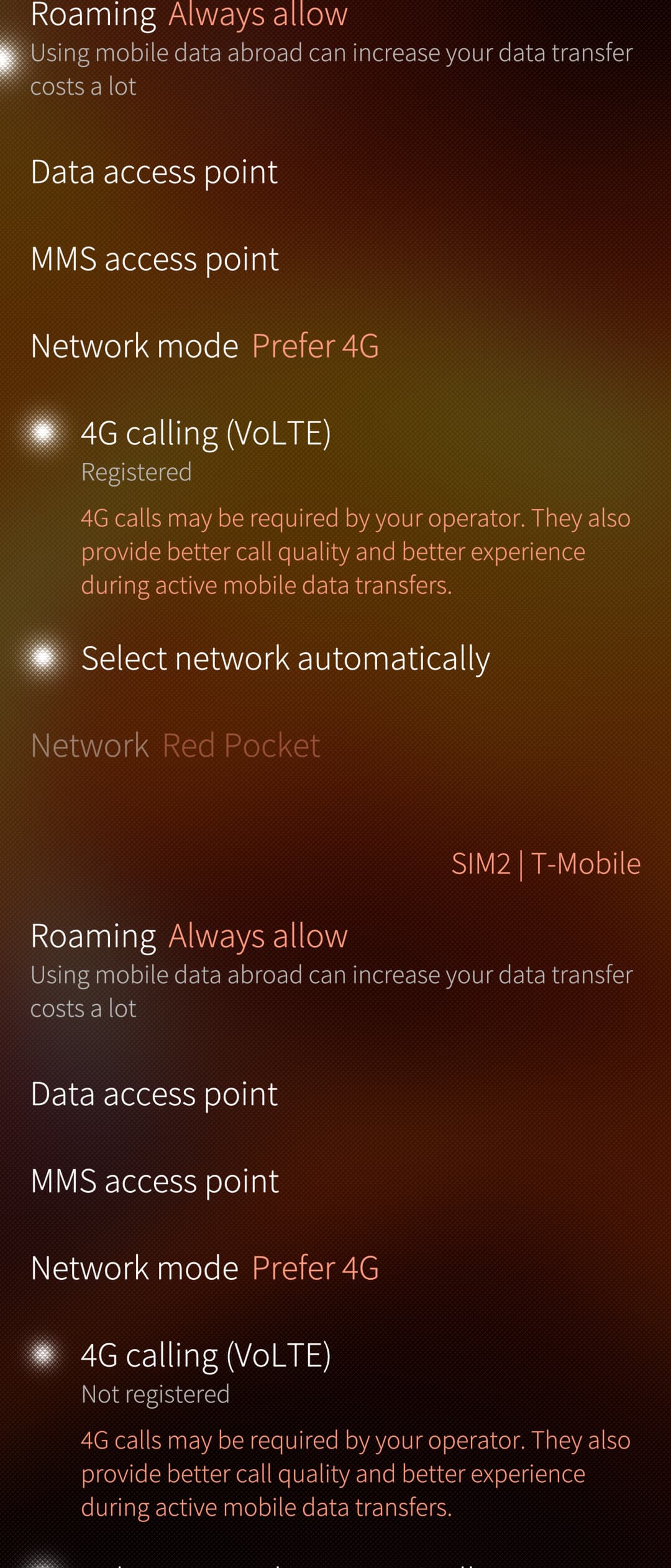

Hi there! Long Long Time US user here… Started with the Jolla Phone and still here. But Man it’s a stone cold struggle!! I am not going to lie… MMS nor phone work well here on East Coast T-mobile in my city (Mid-Atlantic State)
I have Red pocket an I bought a T-mobile Branded sim from T-Mobile, both are a no go,
  • The Phone does not play an Outbound Call Ring Tone.
  • People I call Hear an Echooff themselves or My voice turns Robotic
  • I miss calls alot, I miss SMS a lot… some time my SMS will not go out.
  • If I don’t Reboot the phone after a few days It stops taking calls and I can’t call out. No one can call in, they say they get fast busy or it goes direct to voice mail. I guess it gets Unregistered from the network. So I may go 3 days without calls or text before I even notice it.
This is my Second 10 III, my first one was single sim, this is one I am on is duel sim. With past version of the OS things were better on the single sim The Duel sim is just full of hard nopes for me.
But I refuse to use apple or android so I just deal.
If I am honest, most people would not not recommend this phone here in the US. I could be wrong but My Phone and T-moibile are not working well together.
In the screen shots I can’t get pictures or group messages because they come over as MMS.
