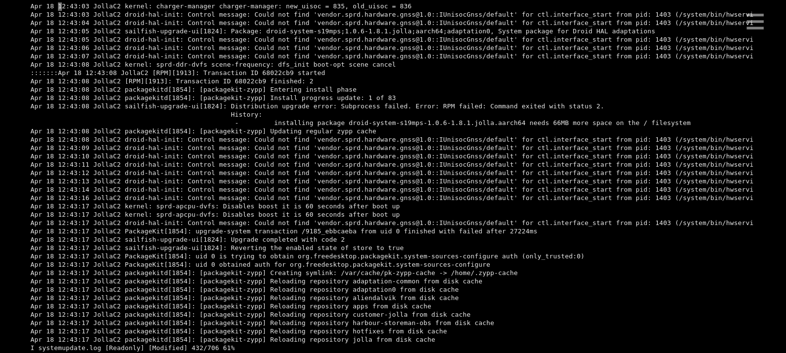

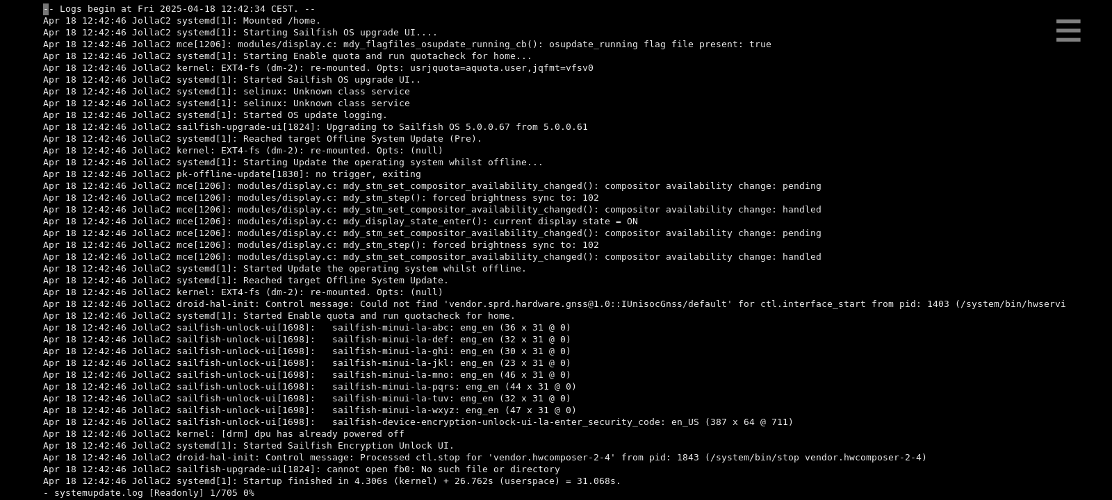

The OTA update on the C2 doesnt work. After reboiting it says uodate failed try agsin later.
What should I do? Afaik there is no factory reset button on the C2.
The file
/var/log/systemupdate.log
may contain a hint on what went wrong with the update.
Thats the logfile. Not sure what went wrong
Ah the error might be here. So is there just not enough space on the root partition?
Thank you very much @duvi
I took me only one second attempt since you posted your solution before. Have a great Eastern.
