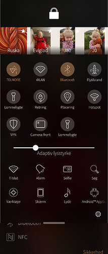

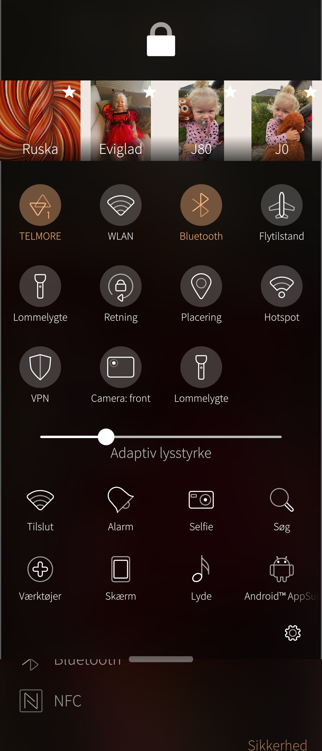

@elkiaer does mobile data otherwise work when you have roaming disabled?

Yes the mobile data is working.
