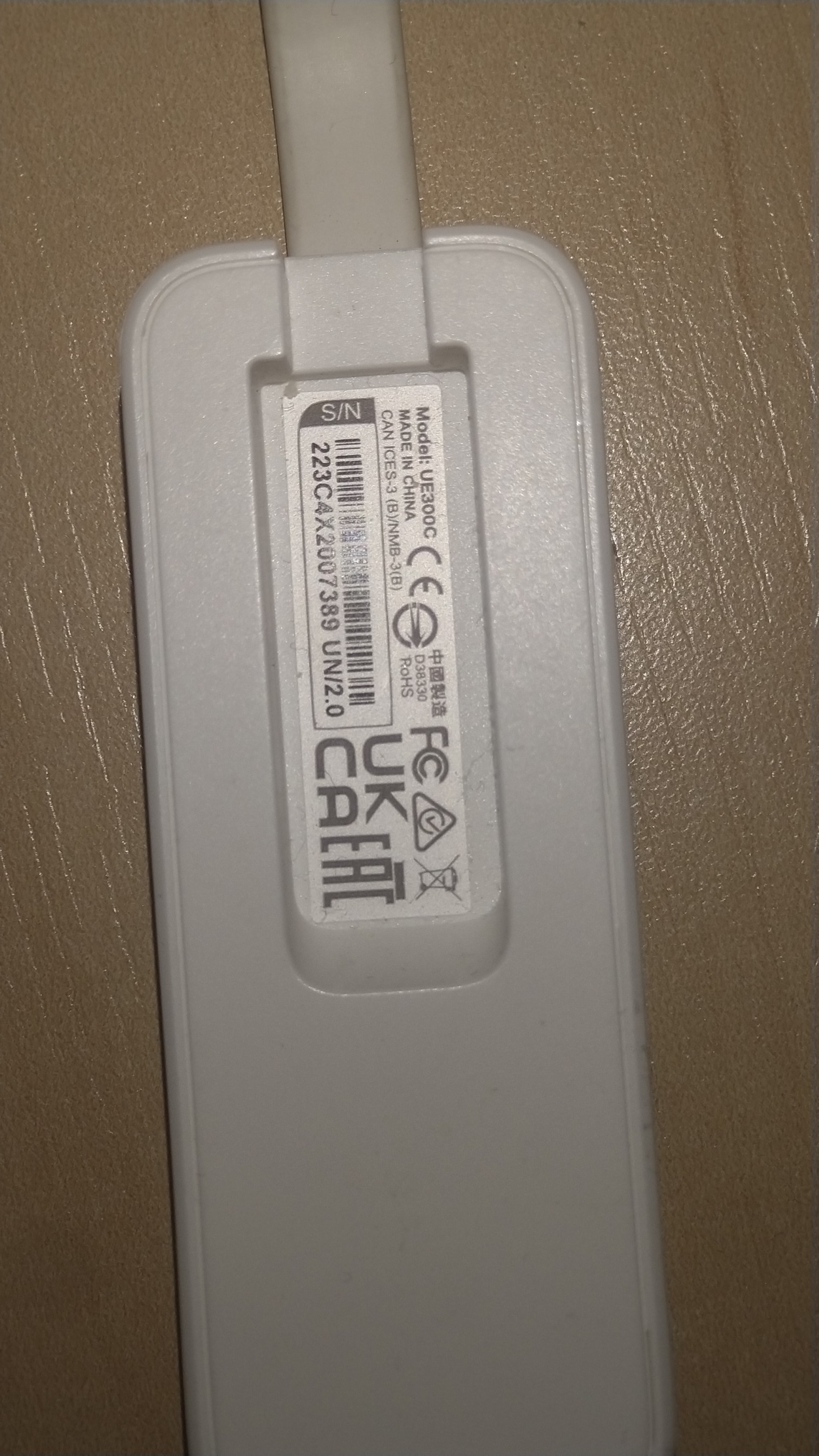

Have successfully connected an USB dock to the phone and keyboard + mouse works now fine. Next step is cable network. This is my adapter, connected to the USB hub:
How can I set up this device by CLI? There are no additional settings nowhere in the GUI settings menu after physically connecting the adapter.

Xperia 10II connected via tp-link usbc adater to Lan . see picture.
Sending this one with mobike and wifi disabled.
