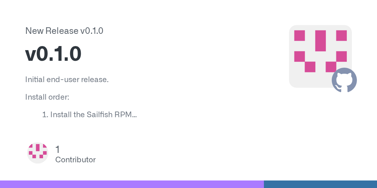

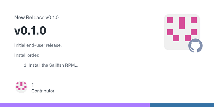

How do you install it?
I shared on GitHub the things you need to download, friends. After installing both of them and completing their full setup, it should work. But based on the tests I did over 3 days, sometimes the service can disable itself. The installation is complete, but sometimes the transmitter service stays paused at that moment. If you run into a problem like this, what you need to do is =
If Coordinate Transmitter receives the coordinate but Pure Maps does not open:
  1. Make sure the Sailfish RPM is actually installed
  2. Then run as defaultuser:
systemctl --user daemon-reload
systemctl --user enable coordinate-transmitter-watcher.service
systemctl --user restart coordinate-transmitter-watcher.service
You can verify with:
systemctl --user status coordinate-transmitter-watcher.service --no-pager
If the service says “Unit coordinate-transmitter-watcher.service could not be found”, the RPM is not installed yet.
Install it first:
devel-su
rpm -Uvh --force /home/defaultuser/Downloads/Coordinate-Transmitter-sailfish-0.1.0-2.noarch.rpm
exit
