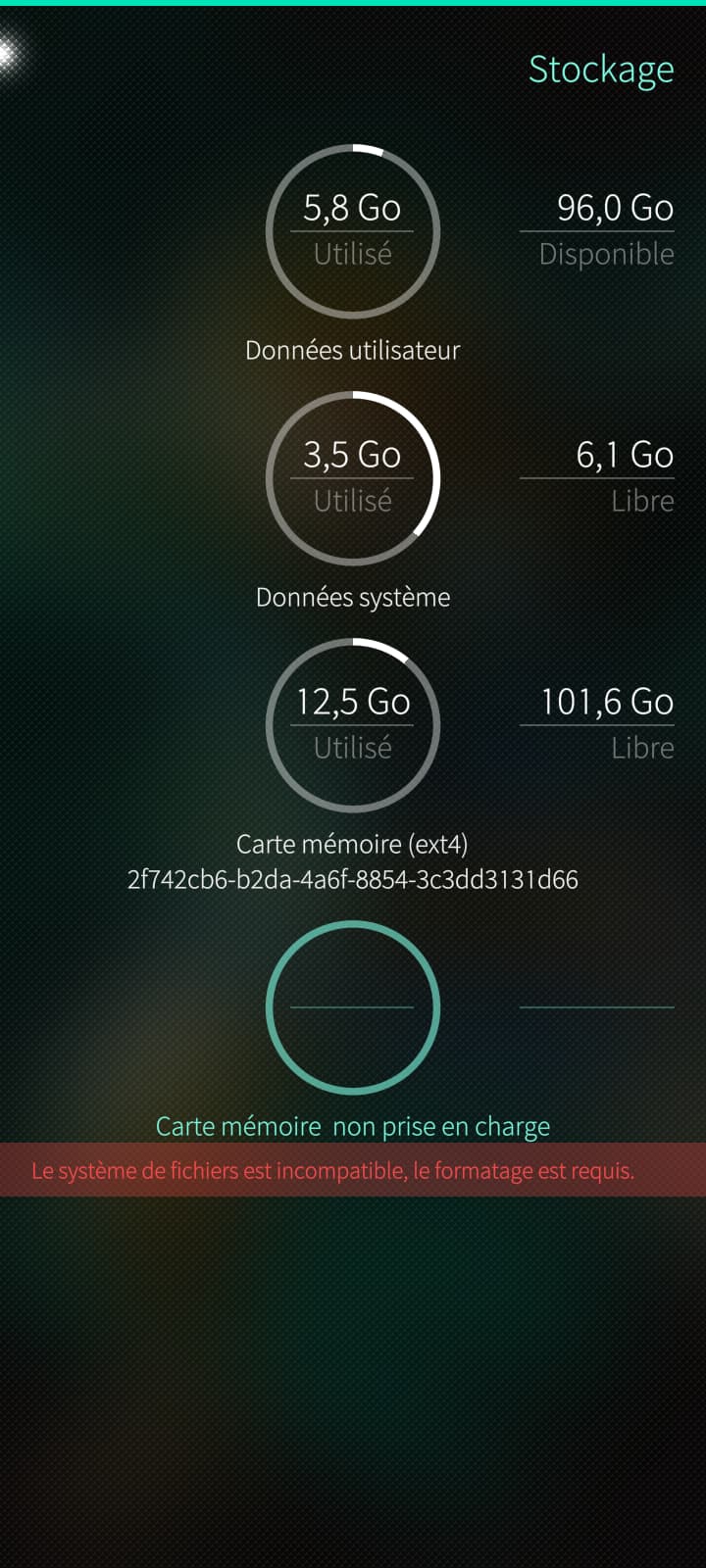

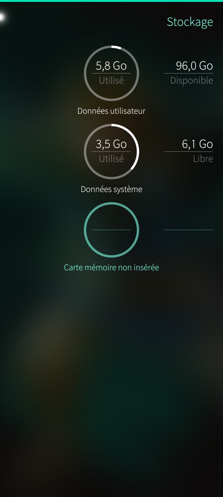

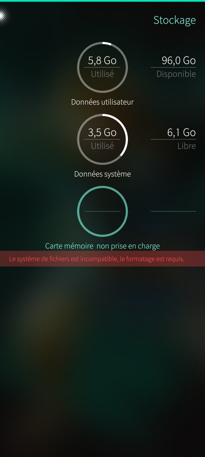

Hi, I put on my JollaC2 a 128Gb micro SD XC V10 card (formated to ext4). And sometimes card is see and mount and I can browse. Sometimes card isn’t mount. Sometimes there are an error of format.
Some screen capture:
This card come from my Xperia. No problem in Xperia, no problem in PC.
I put another card (32Go VFAT) and no problem in Jolla phone. Log from dmesg I found on mmc:
