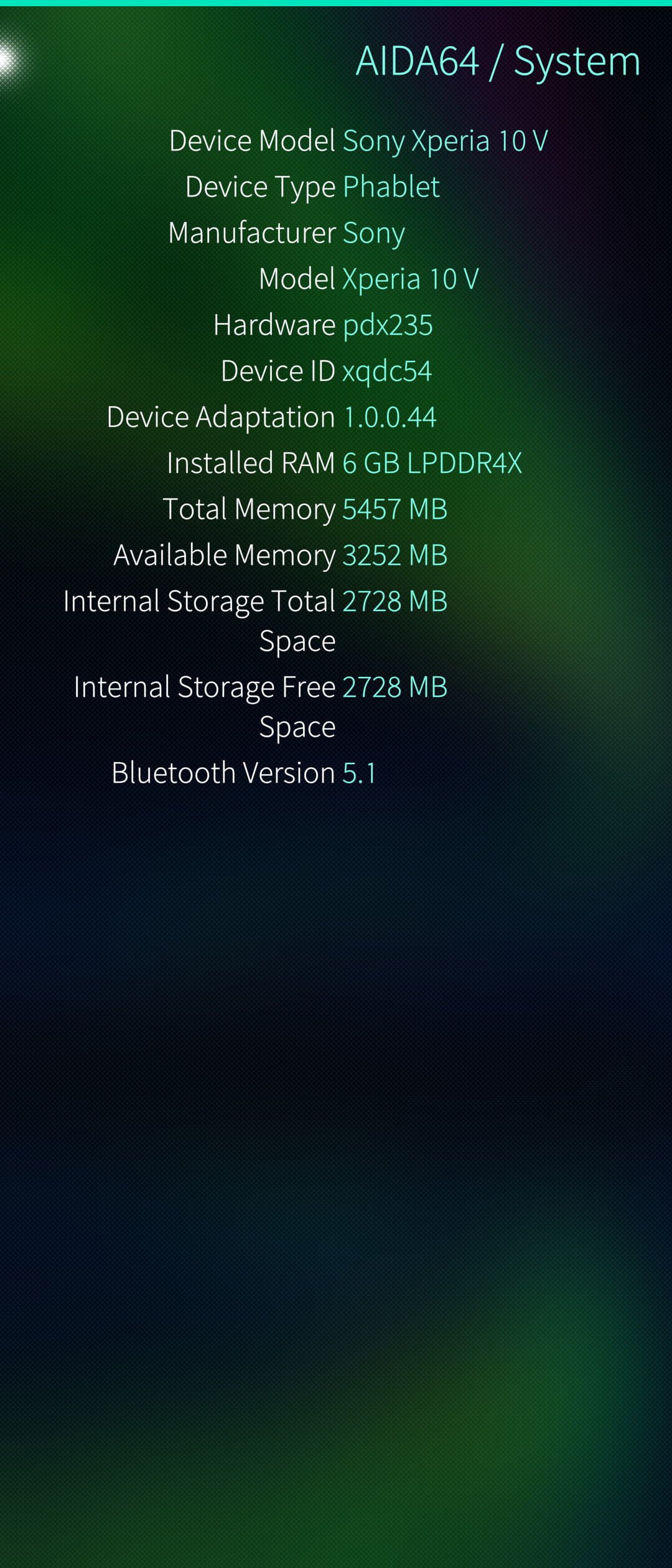

Can you install AIDA64 and see what hardware you have?
My model is the same as yours, but maybe there is some other more subtle difference.
