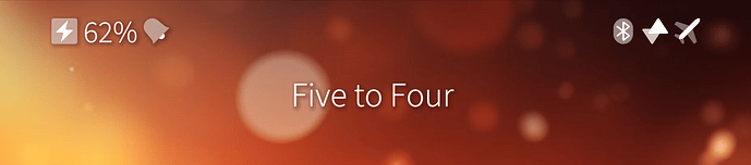

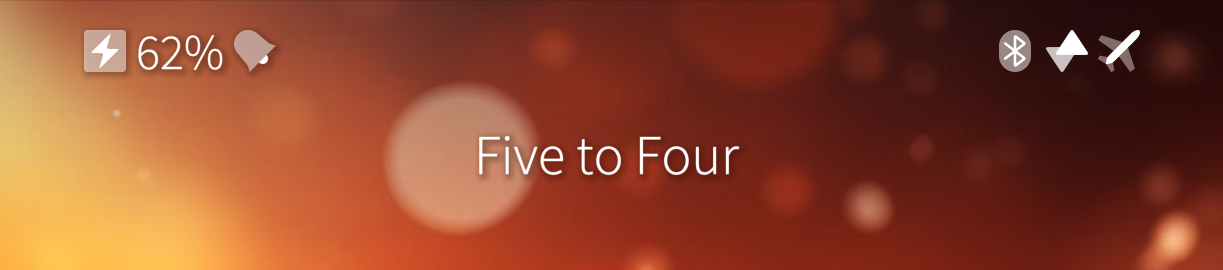

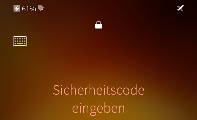

I’ve been having a problem with my Fairphone 5 (5.0.0.62) for some time now. For a few days now, the FP5 has always started in flight mode.
[Note: in this case my mobile data is enabled, but that isn’t always the case. It is also possible that it is inactive and can’t be activated.]

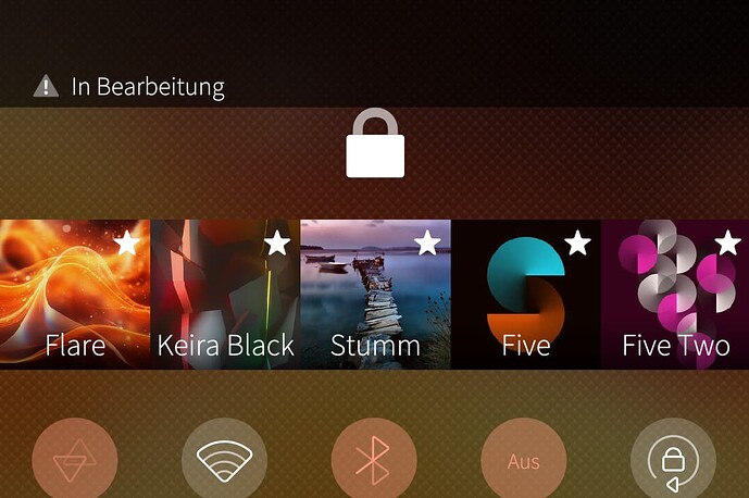

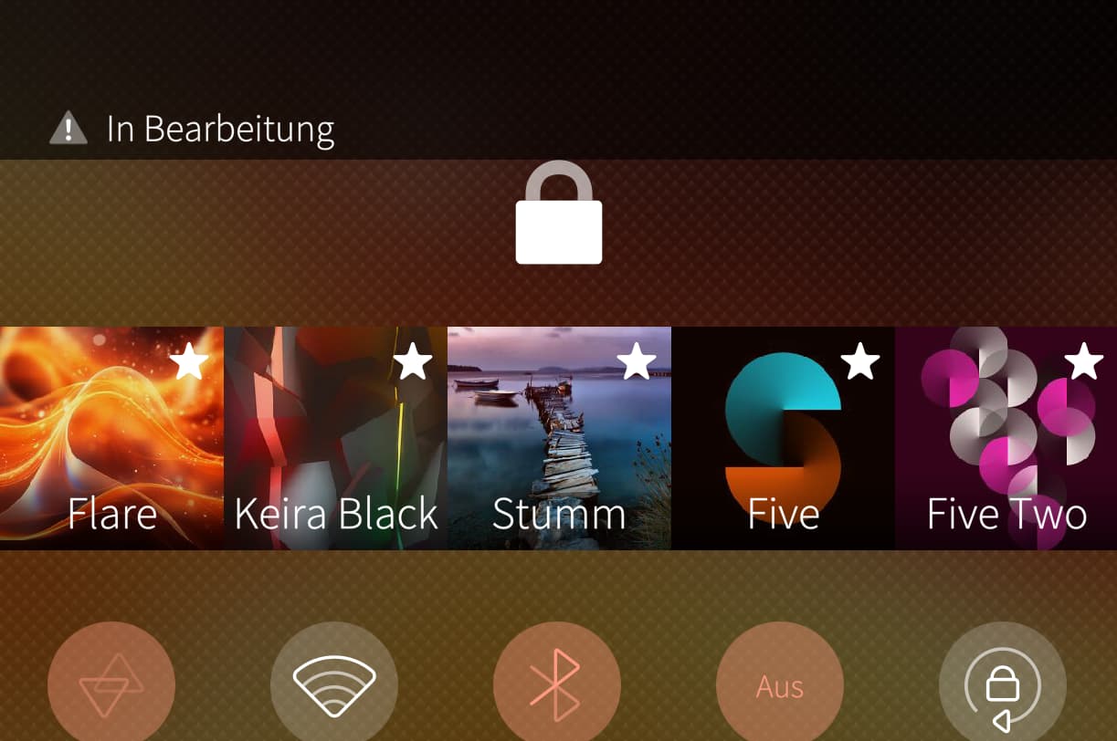

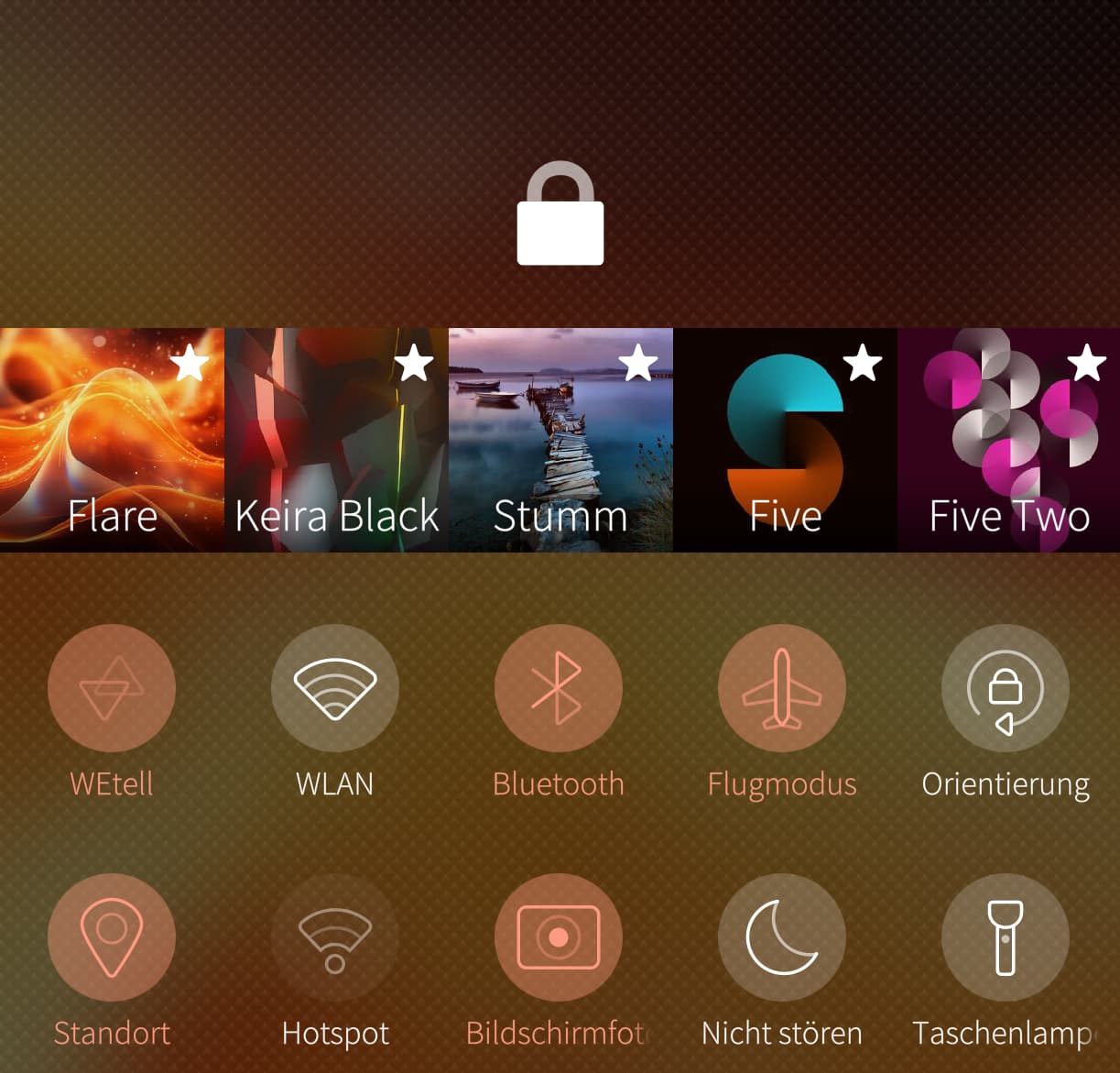

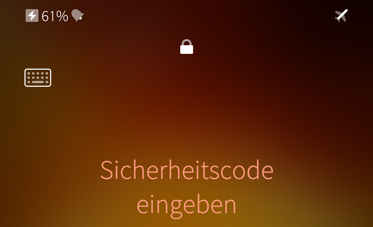

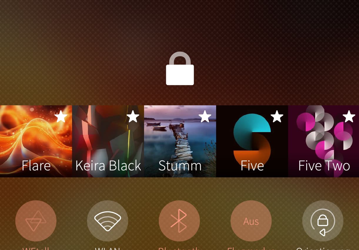

I am still asked for a PIN for my SIM. When I want to deactivate flight mode, the button label switches to “off”, but flight mode remains active (sometimes WiFi is still active, as is BT).
Pressing the flight mode button again triggers an “In progress” banner, but nothing else happens.
Sometimes restarting the network with the utilities helps, but sometimes not. I have also found that it may be possible to deactivate flight mode before entering the PIN.
