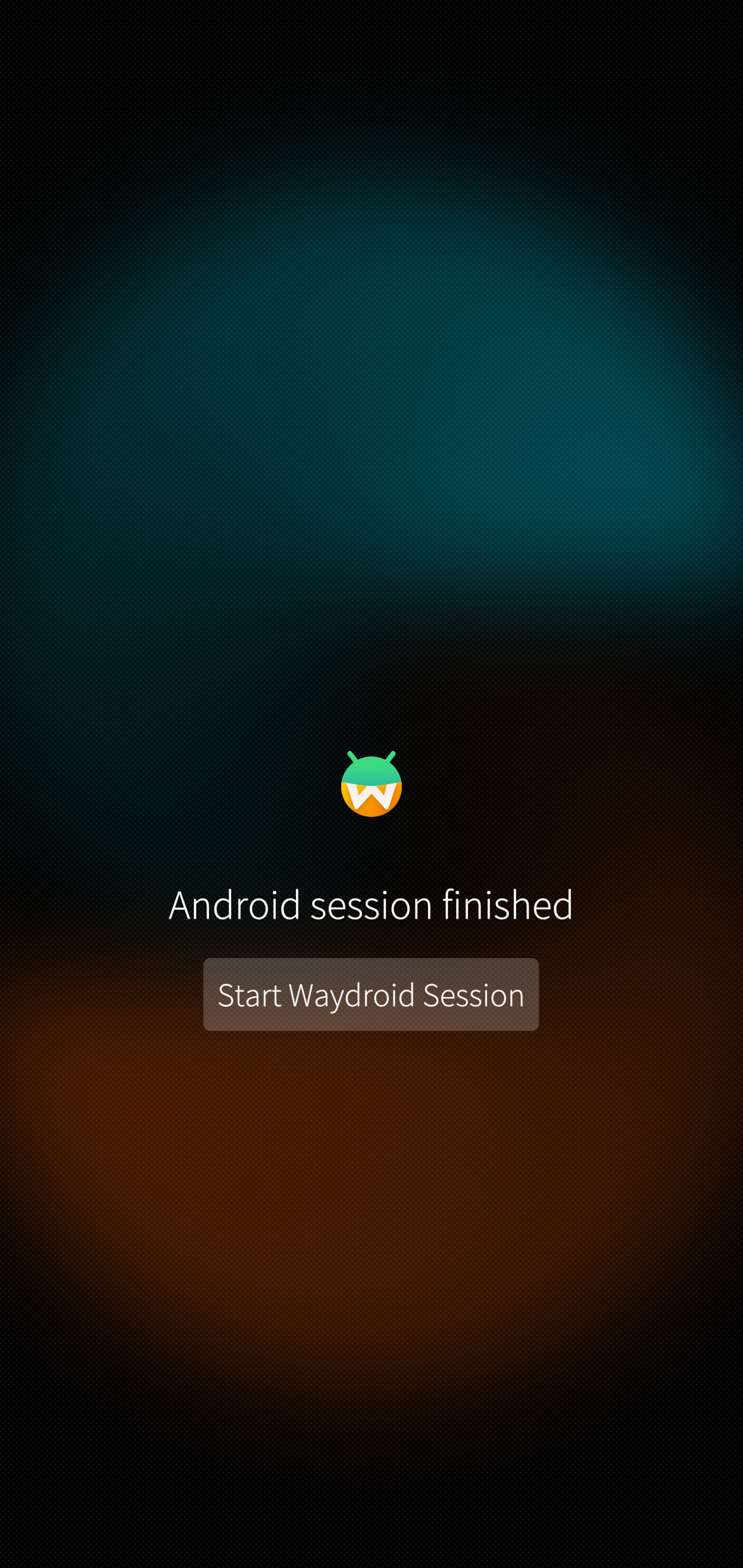

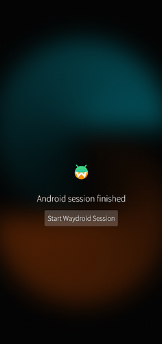

Waydroid does not start after upgrade to 5.1. Any advice
Waydroid after update not working with the following. … (which used to work)
mount /home/waydroid/images/system.img /mnt/waydroid/
ln -s /vendor_extra/etc/media_profiles_vendor.xml /mnt/waydroid/system/etc/
umount /mnt/waydroid/
@carmenfdezb mentioned something about starting apps with waydroid-runner but not sure what that means as i don’t use waydroid
As @Mister_Magister mentioned, you have to start waydroid with waydroid-runner app
Where to get it from ?
Following does not work …
I reboot my phone when it happens that and then it works for me
I’ve installed waydroid runner from chum
It helps me: devel-su systemctl stop dnsmasq.
^^ Thanks, but both tips not working. How do I deinstall and reinstall waydroid in a proper way? In terminal.
…are you on 5.1. ? Since upgrade it doesn’t help me anymore.
