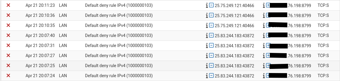

Hello, my firewall caught some strange behaviour that is guaranteed to be related to my SailfishOS installed Xperia 10 III. Just thought I’d ask around to see if anyone here has seen similar behaviour or could explain it to me.
The IP addresses on the right side of the screenshot above are one of my telecom provider’s MMS servers, which I know from the port being used, having manually entered it into the settings on SailfishOS. However, the 2 IP addresses on the left are not anything I recognize. Some whois requests say the IP addresses belong to a range assigned to the UK Ministry of Defense. However, my firewall is listing this as a LAN initiated request, and I’m definitely nowhere near the UK, and my LAN has the standard 192.168.0.0/16 assignments. I know this request is somehow involving my Sailfish device, both from the timing (I was fooling around a lot with re-flashing and setting up my Xperia earlier that day), and because my Android devices never contact MMS servers through my WiFi network.
Again, just wondering if this can be explained by anyone here or if similar behaviour has been seen by others in the community…

Huh, I must have made a pretty big typo. Still confused as to why it’s showing up as a LAN originating IP, and why it would be contacting the MMS server. Perhaps a question partially better suited to pfSense’s forum.
Caught the behaviour again, though with IP 25.211.140.233. ICANN is corroborating my initial finding this time. Anyways, I wonder if this behaviour of trying to send/receive MMS via WiFi is a known bug? As far as I can remember they’ve always been forced to go through cellular data. Perhaps it is why MMS refuses to work here in Canada. That or I need to phone my carrier’s tech support to force associate my IMEI with my account, since it doesn’t seem to do it automatically…

If you catch the event while it is happening, try (on the phone):
devel-su netstat -anp | grep [source port]
Which should gives you the process that owns the connection.
(Or if you want to be fancy about it, use the ss tool instead of netstat.)
devel-su ss -plants  dst = 25.0.0.0/8
devel-su ss -plants  dport = :47600
devel-su ss -plants  dport = :8799
… and if you want to be really stupid about it, you could use googerteller:

On another note, the folks over at the pfSense forum suggested that this behaviour could indicate a problem with network stack configuration. Does anyone know how I could check on and troubleshoot such things?

Well, my carrier here in Canada does not own any IPs in the 25.x.x.x block at all, and current IP while on mobile data in my area is not a 25 address either. So while my firewall is seeing something triggered by uploading/downloading MMS content, something’s going wrong with the network software somewhere. And the two experienced networking people over at pfSense seem decently certain about their conclusion, I just don’t know where to go from there.
I tried the ss tool, the process is (probably as expected): mms-engine (pid=11525,fd=11) from 192.0.0.2, both with and without WiFi connected
