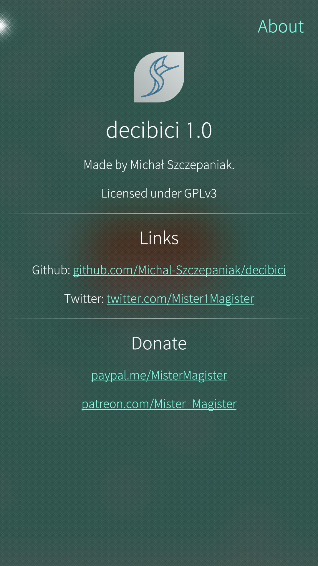

Ladies and Gentleman! my Friends, we have a working app now.
https://github.com/Michal-Szczepaniak/decibici
Its a great small app with the funny name
“decibici”
decibici can switch the bike on/off. Tested on Cowboy 2 bike.
All credits go to @Mister_Magister who wrote this app in 2 6 hours. After just 4 iterations, the app worked like it should. My Cowboy 2 bike could be switched on and off.
For me it is not only one handy SailfishOS app, its also an Open Source Replacement for the closed original Android Application, which never worked in Android App Support, because of the direct Bluetooth connection. Its an SailfishOS App which might be the base for further eBikes or another BTLE connected devices. And this make me very happy.

It will land in storeman once my man gregguh makes icon for it
also i’ll add thanks to @piggz for qble and helping me with qble
