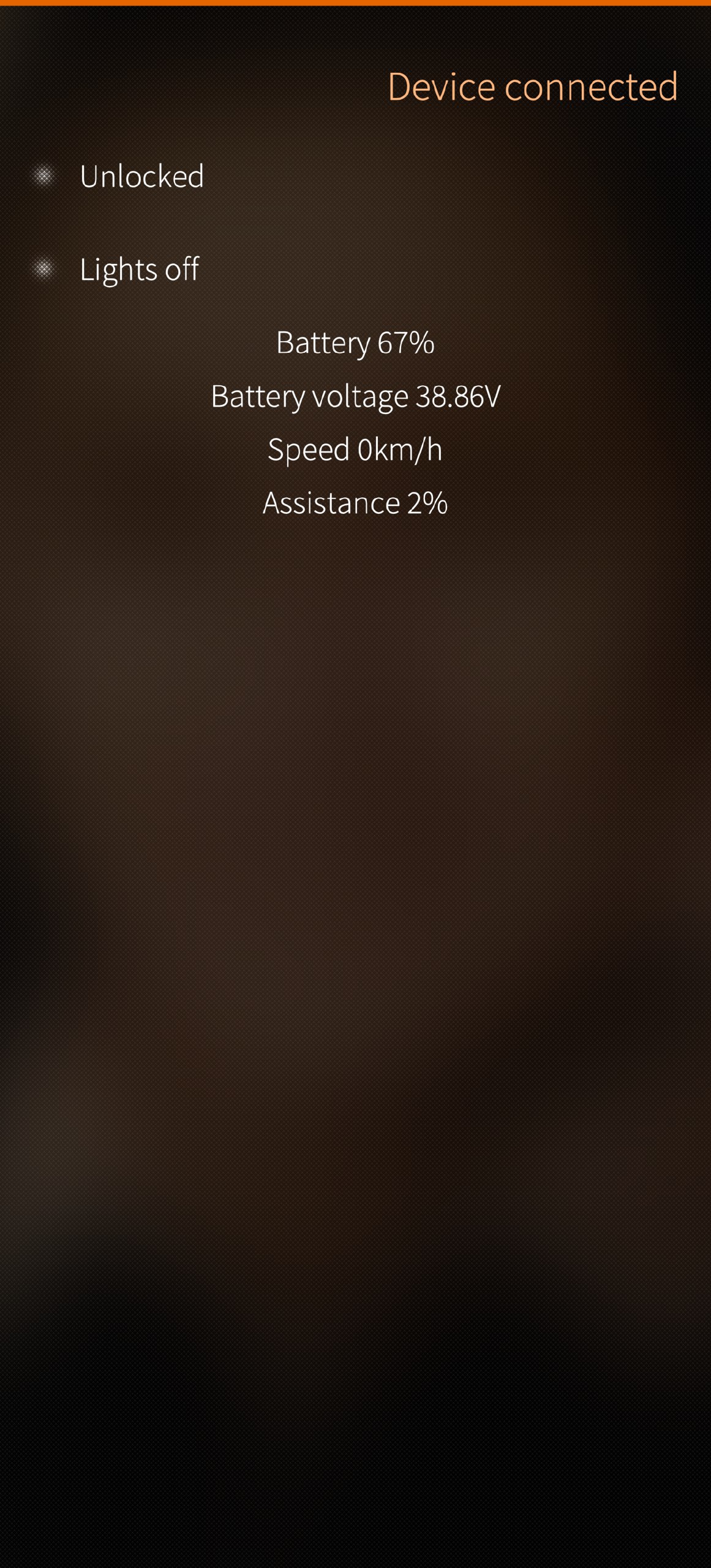

Today @Mister_Magister spend literally the whole Sunday to update decibici app. The most time took testing and debugging for the lights on/off feature, which is unfortunately still not working. It should work but it doesn’t. The state is preserved when i switch light on/off in the android app - decibi recognizes the state correctly. but its still not able to switch it on or off.
Anyway, i am very happy that the app made good progress and matured.
Now it support following features:
  • Automatic connection to the bike (when it was paired before). No need to manually connect via SailfishOS Settings → BT.
  • Battery capacity
  • Battery voltage
  • Speed
  • Assistance
The updated code is on Github https://github.com/Michal-Szczepaniak/decibici
If someone have an idea how to make light working - it will be very welcome.
