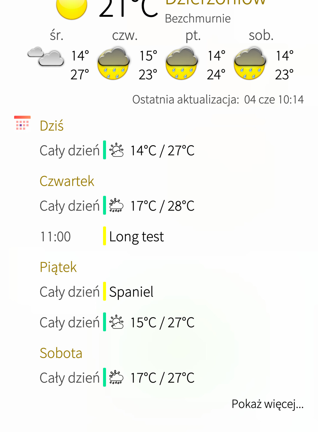

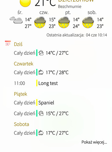

Event view. Notice that “Long test” and “Spaniel” events are shown on their start days only.

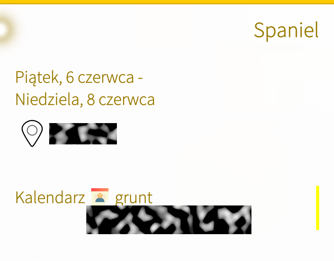

Details of “Spaniel” event — all day event spanning from Friday, June 6th to Sunday, 8th.

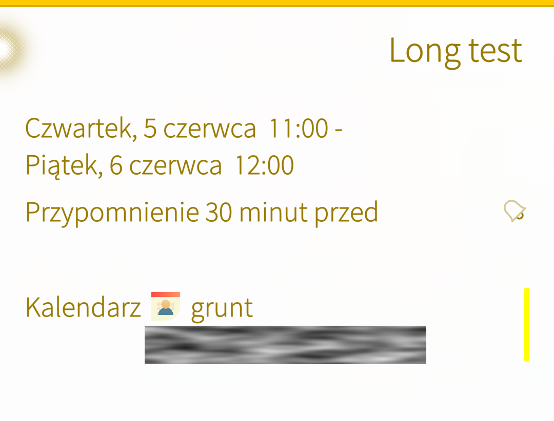

Details of “Long test” — normal event spanning from 11:00, Thursday, June 5th to 12:00, Friday, June 6th.
