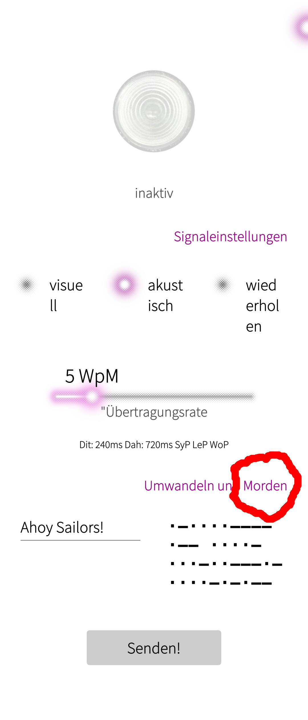

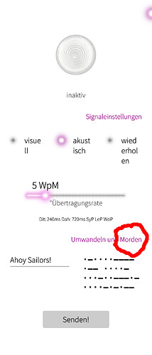

Report of a small typo in german translation:

About the typo, ‘morden’ in german means ‘to kill’ !
I know. I finally made a Killer App!
I’m very happy to have this app now! Thanks very much again @nephros !
I love the German translation that says „morden” instead of „morsen”.
