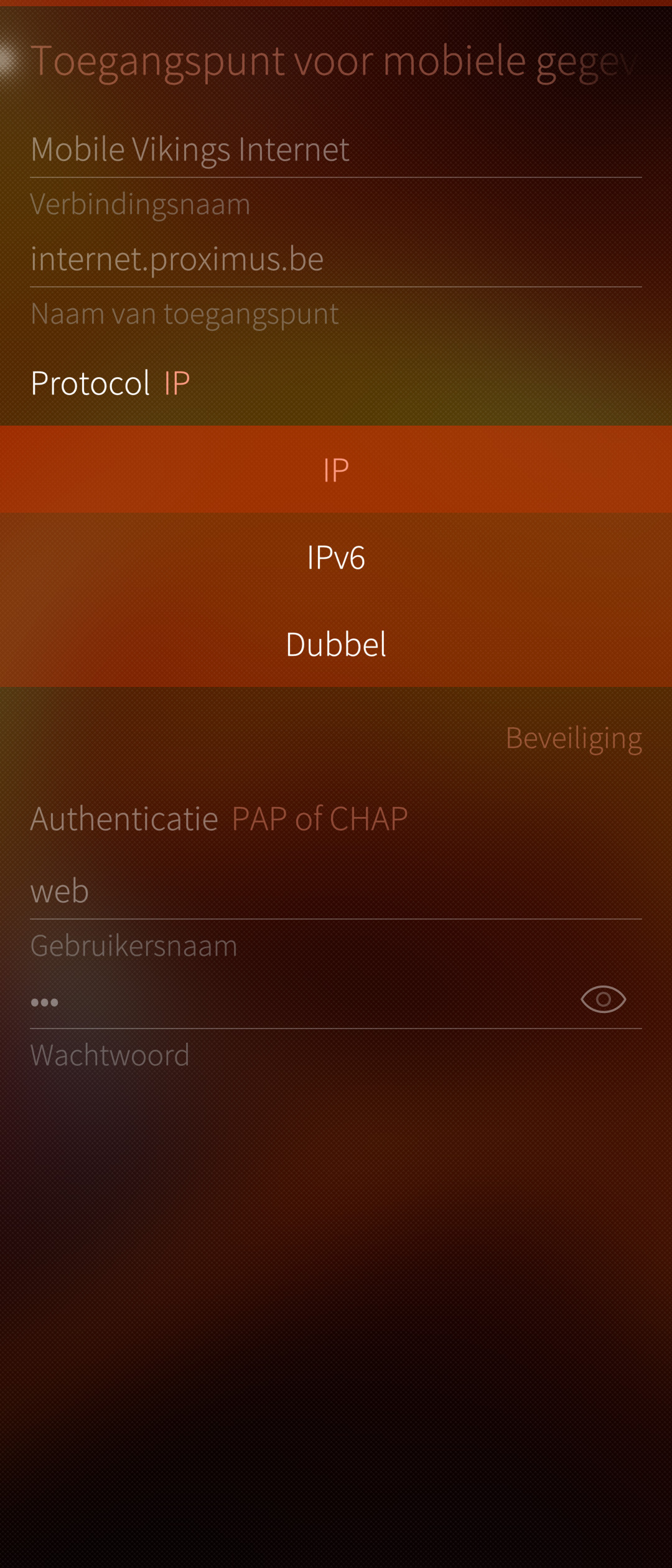

Iirc, this is a known issue on the IV. If you disable IPv6 on mobile, things behave.
Thank you for the tips, I was indeed in mixed mode, I changed it to IP, but this still doesn’t works. And strangely enough I still receive an IPv6
Might be you need a reboot after setting the setting. I seem to recall sometimes it moves back. @mal, I seem to recall we once had a chat about this to get some parts reset correctly, with a whole bunch of reboots, and I’m quite sure your memory is better than mine on this topic.
I tried that, but it doesn’t change anything.
