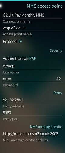

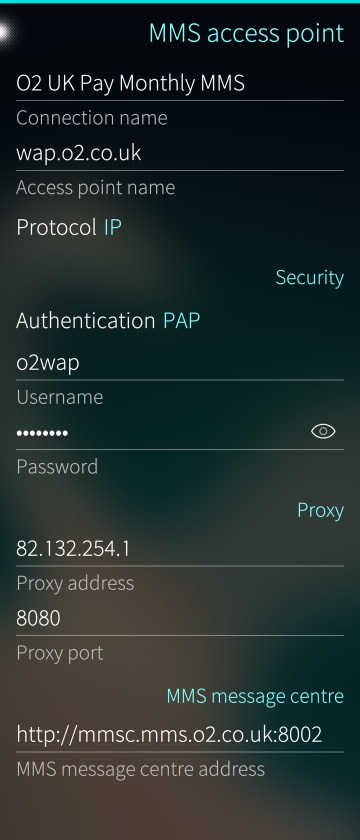

Whether your operator has a bearing upon this I know not, but in the UK with 10III I can send from O2 to MVNO of O2 and to EE. I can’t remember whether I had to send an MMS to myself to initiate process in the first place.
