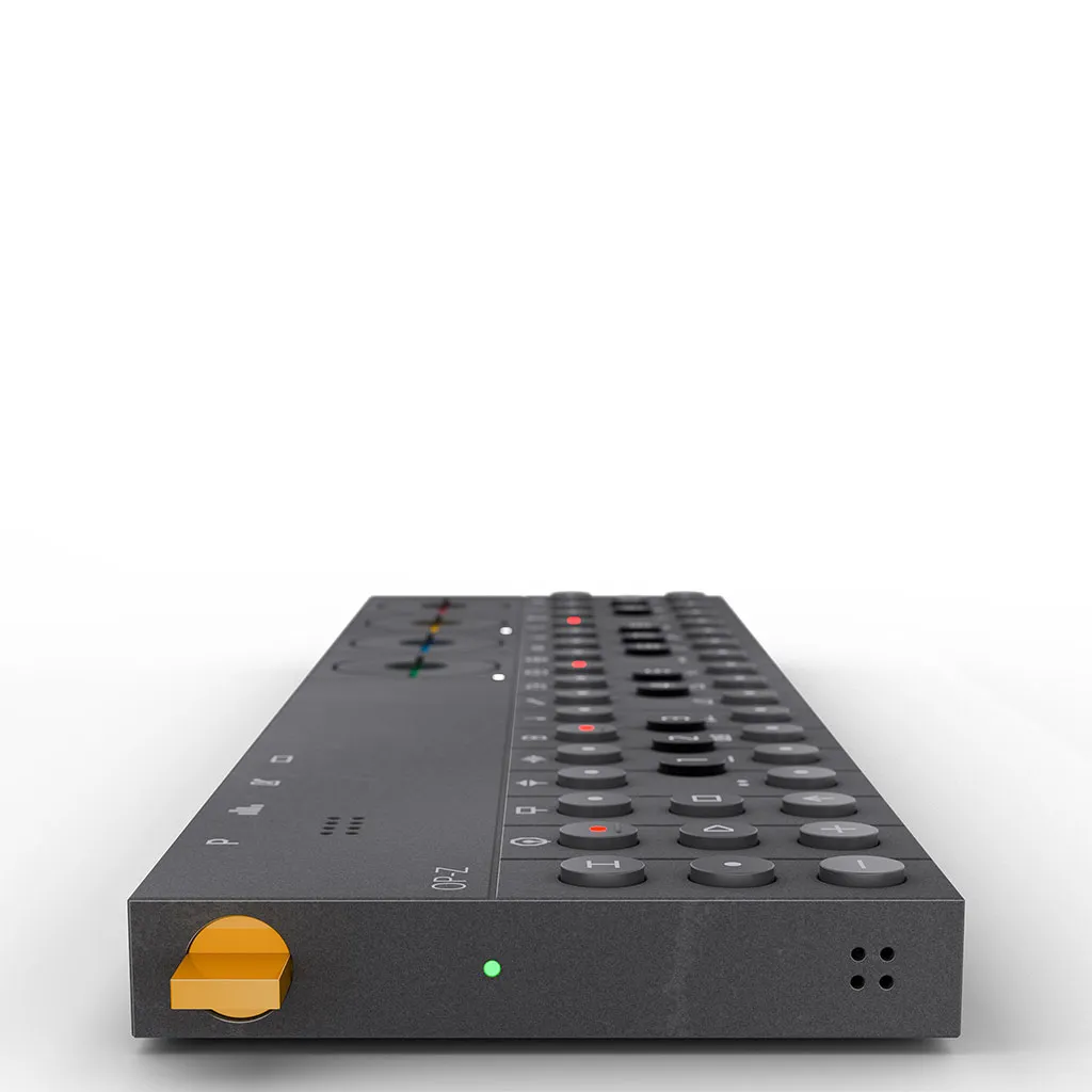

Actually, my secret wish is to MIDI record tracks made on the incredibly crazy powerful Teenage Engineering OP-Z, then transform/polish them, and re-inject them into the device.
The only flaw it has, is not being able to zoom into the patterns (as the Deluge do) to temporally adjust each note separately (when stored on the same step).
Here is the lovely machine, which has USB MIDI and USB audio.

edit: I tried to plug the OP-Z on the phone.
Some tasty things appear with journalctl -f
