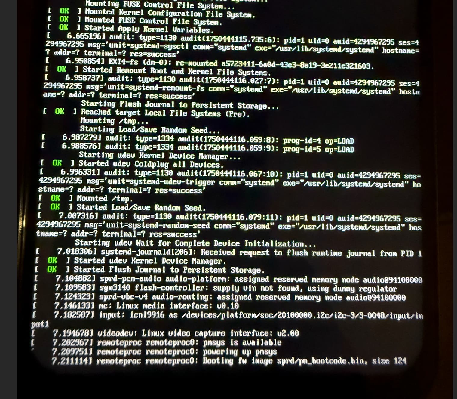

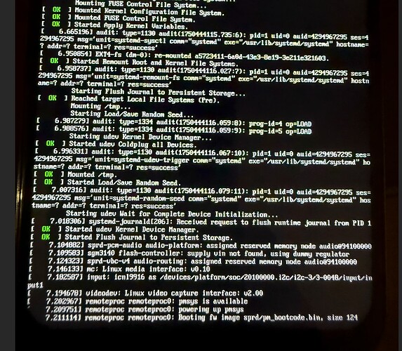

When power charger is plugged into phone and you boot it up sometimes boot process hangs on booting fw image for pm_bootcode.bin
