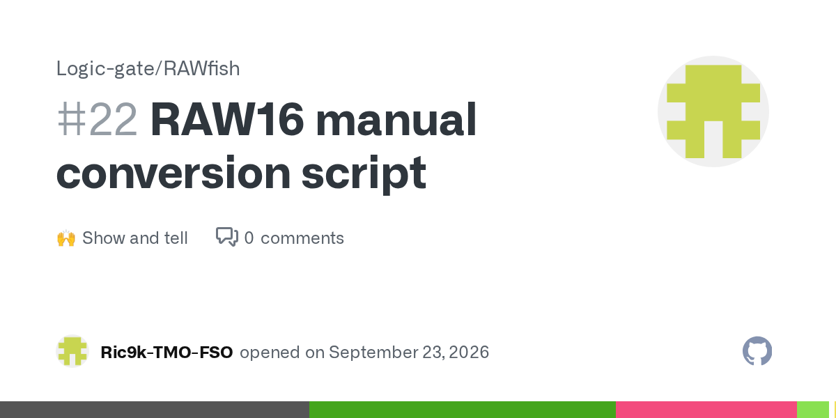

How can I open Raw16 files on a computer? I tried to open one with Luminar (and also renamed it to DNG).
My vision after the first drink is like the “High” or “Fast” denoising modes :laughing:
Good work, impressive!
I like my photos to be crisper, without blurring the details too much. My Canon EOS 100D also produced photos like that with its default settings. But the noise it produces looks nicer—thanks to the larger sensor and better optics—more refined, so to speak.
Maybe someone can find a good software noise-reduction algorithm for JP26.
You can find a python script to manually convert RAW16+json file to a DNG file here:
However, RAWfish can produce a DNG. This can be chosen in SfOS settings → Rawfish

Like @ric9k said, we have native DNG renders. You can enable it via the Settings → Apps →RAWfish →RAW capture files.
