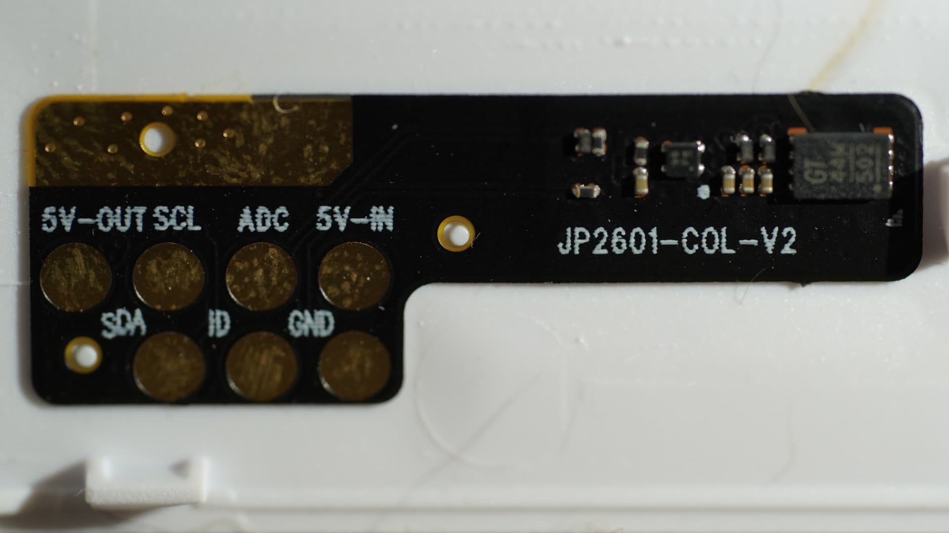

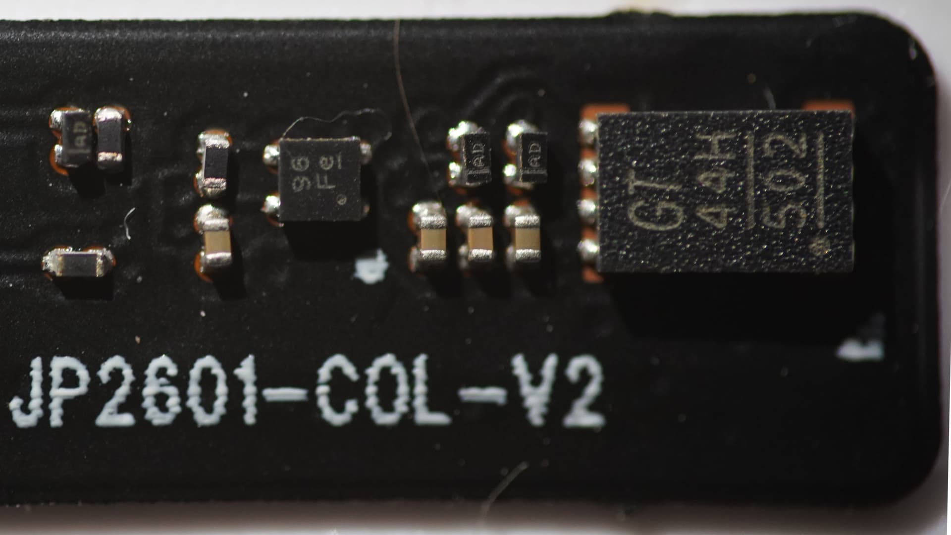

I now received my TOH cover Snow White. It does nothing, yet it comes with electronics.
The component comes with marking GT 44H 502, which the internet says could be an LDO voltage regulator. What’s the point of it?
It’s probably meant to help the phone identify the connected TOH. Maybe Jolla plans to do something about it later on the software side (or at least leave an option for doing something).
The point of electronics in a dumb TOH in general is to be able to tell what color it has and change ambience from it (not yet delivered?). The point of an LDO specifically is presumably to dive the other chip which holds the identification.
The other internet says it’s a Giantec GT24C02 series I²C serial EEPROM, a 5 volt device with 2 kilobits of storage (256 bytes). If this is indeed true, the point of it might be to store an id of the Snow White cover so the phone can recognize it when connected.
The memory layout is described in the link from @avhakola above. Most of it is unused (available to the owner of the phone to store whatever).
