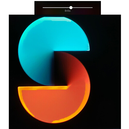

Jolla Phone 2026 – Black crush below a certain brightness threshold
REPRODUCIBILITY: 100% always
OS VERSION: Sailfish OS 5.2
HARDWARE: Jolla Phone (2026)
UI LANGUAGE: Spanish
REGRESSION: Not tested in previous releases.
When I lower the brightness, details in dark colors are lost below a certain threshold. Ptu said this in another topic: “Your issue could be the panel switching from DC dimming to PWM at a threshold, so yet another issue.”
Photos taken with a CMF Phone camera:
13 intervals of brightness here, because It don’t let me upload more than 5 images: https://app-share.mailbox.org/appsuite/api/share/0f51be5e03143947f7e241e314394c6d81b41dedcf5e71b7/1/8/Mzg/MzgvNDM1
Just changing the brightness.
  1. Lower the brightness
  2. Check dark details
Keep the detail of the dark colors.
Detail lost at dark colors.
None that affects de display.
None
