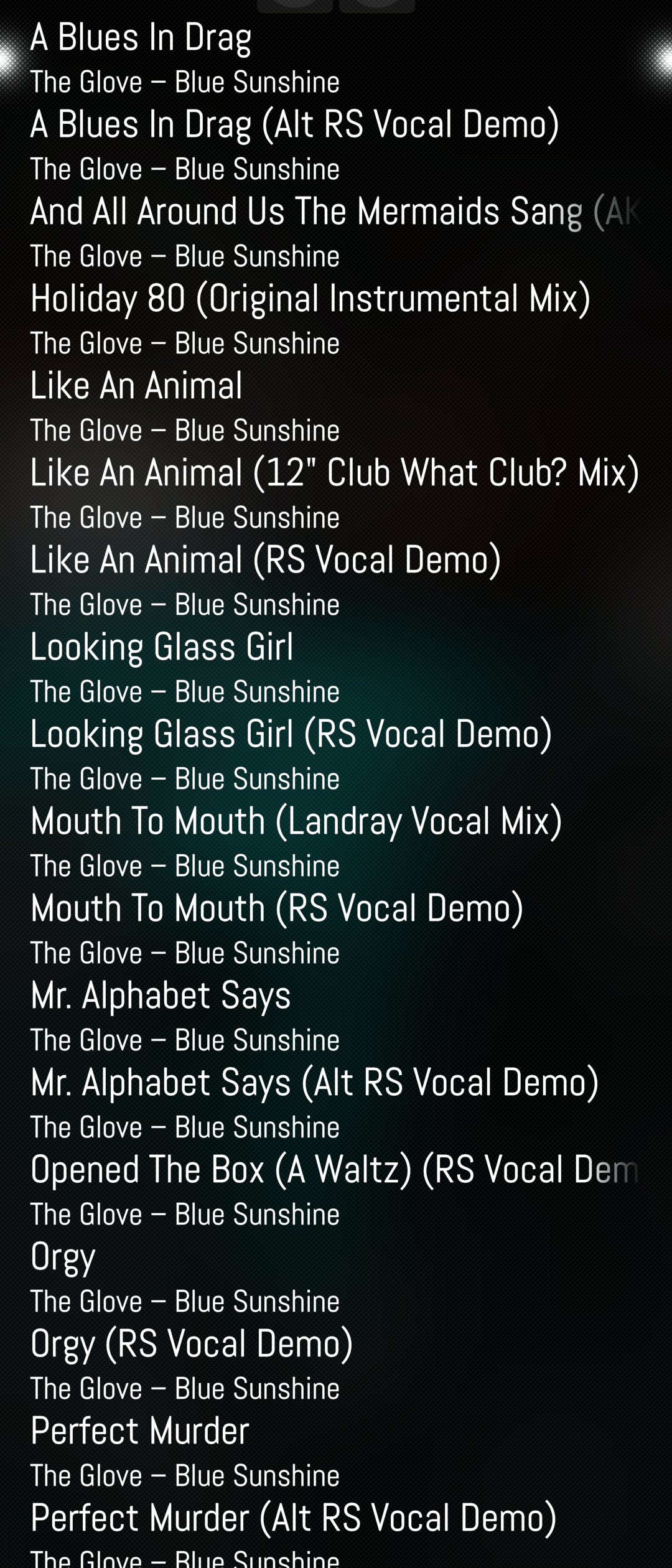

I have made an app called Supersonik. Its a Qt6/Kirigami app so you need to install all the qt6 stuff, see Packaging Qt6 (6.7.2) for Sailfish OS - #22 by decon It is far from perfect, but happy to have feedback GitHub - piggz/supersonik · GitHub Adam Pigg: "Added genre support so Supersonik, my @kde@floss.…" - Fosstodon
