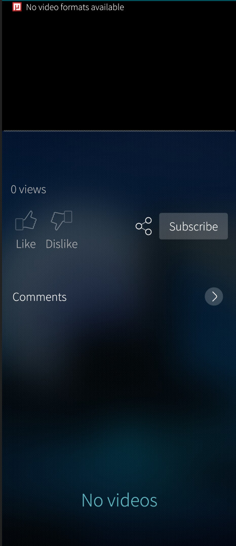

I still have the notification “No compatible video format available” on my C2 after updating. It is just a pity because it is such a cool app. Thanks to the develepper for his work for so far.
might be just that specific video, also you can try editing .config/microtube/microtube.conf and removing poToken and poTokenTimer

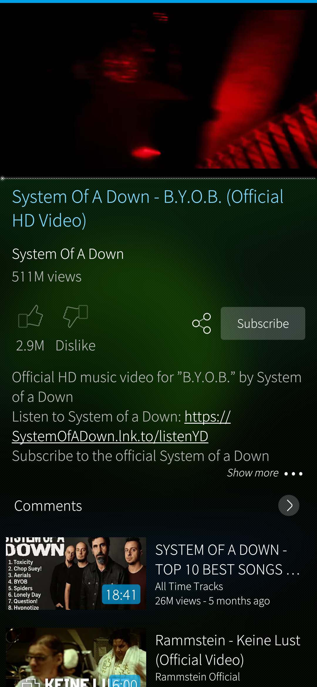

Still works on my side (maybe depends on video ?)

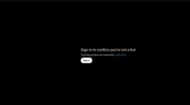

Everything was working fine earlier today, but now I opened the app and got this — even though I didn’t touch anything :face_exhaling:
Sarcasm mode ON: PEBKAC IWFM. Very unfriendly but it works for me.
Update: everything’s working again like before. No idea what that error was. I noticed the issue shows up when I launch the AllRadio app :sweat_smile:
I already explained it like 10 times before.
You’re watching youtube without being logged in.
After some videos youtube will be like “yo, log in if you wanna watch”
and then you get error
And then after some time they lift the ban
you get exactly this screen, you just don’t see it

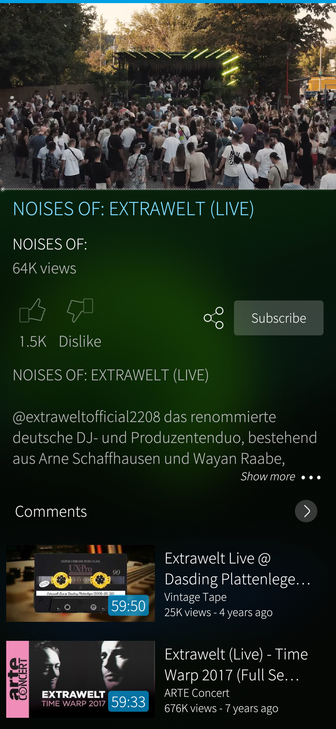

Thank you very much! I followed your instructions, and now everything is synced with my Google account.:heart:

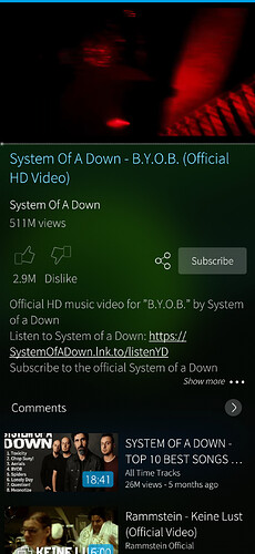

Hello. I finally managed to log in to my Youtube account, but faced no format errors and can’t play any videos.
you managed to do that right as youtube broke microtube so…
So… I’m considering dropping microtube. Youtube has introduced it’s own proprietary format of streaming called SABR (Server ABR) and up until now, it was still possible to use old way of streaming (separate video and audio) but no more. That’s why it stopped working. And I’ve been aware of SABR for some time now, but I put off implementing it as much as I can. Problem with implementing it is that, I basically would have to write my own gstreamer plugin that would parse the data and feed it to gstreamer, which is not impossible but sure as hell it’s time consuming.
Problem is that I don’t look forward to it. Implementing it does not interest me. I, in fact, don’t even use microtube so why would I do that? I was getting tired of youtube constantly making changes so me having to update js library already but this is on whole another level. There are already SABR implementations but those are done in Javascript and that won’t work. Honestly I’m too jaded from all the youtube bullshit. Given that I don’t even use microtube, there’s no incentive for me to spend 1-3 months implementing SABR just so that i can continue not to use microtube.
