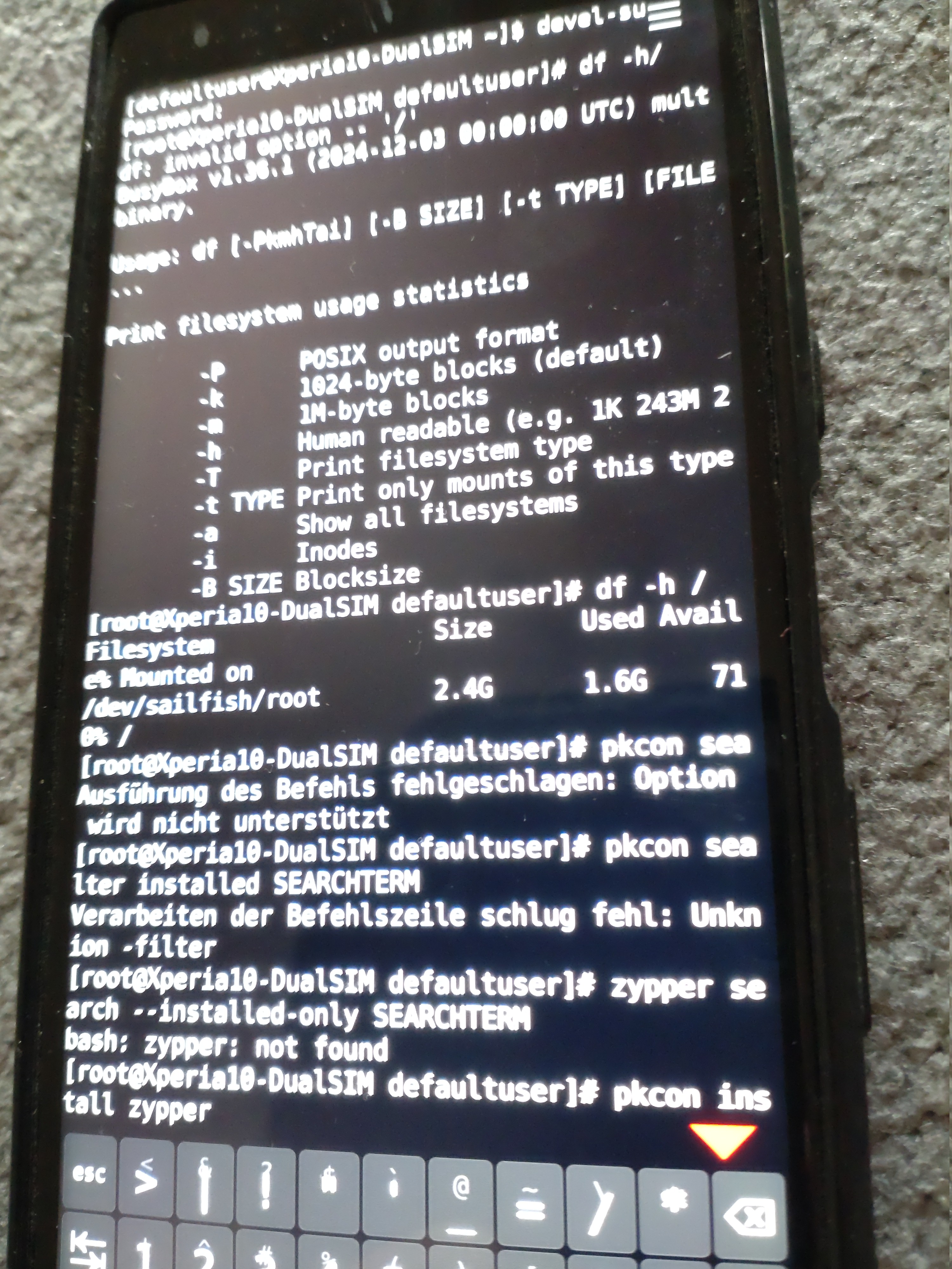

Maybe Terminal or SSH connection works for you?

in here it was told
in “warning nr.1”

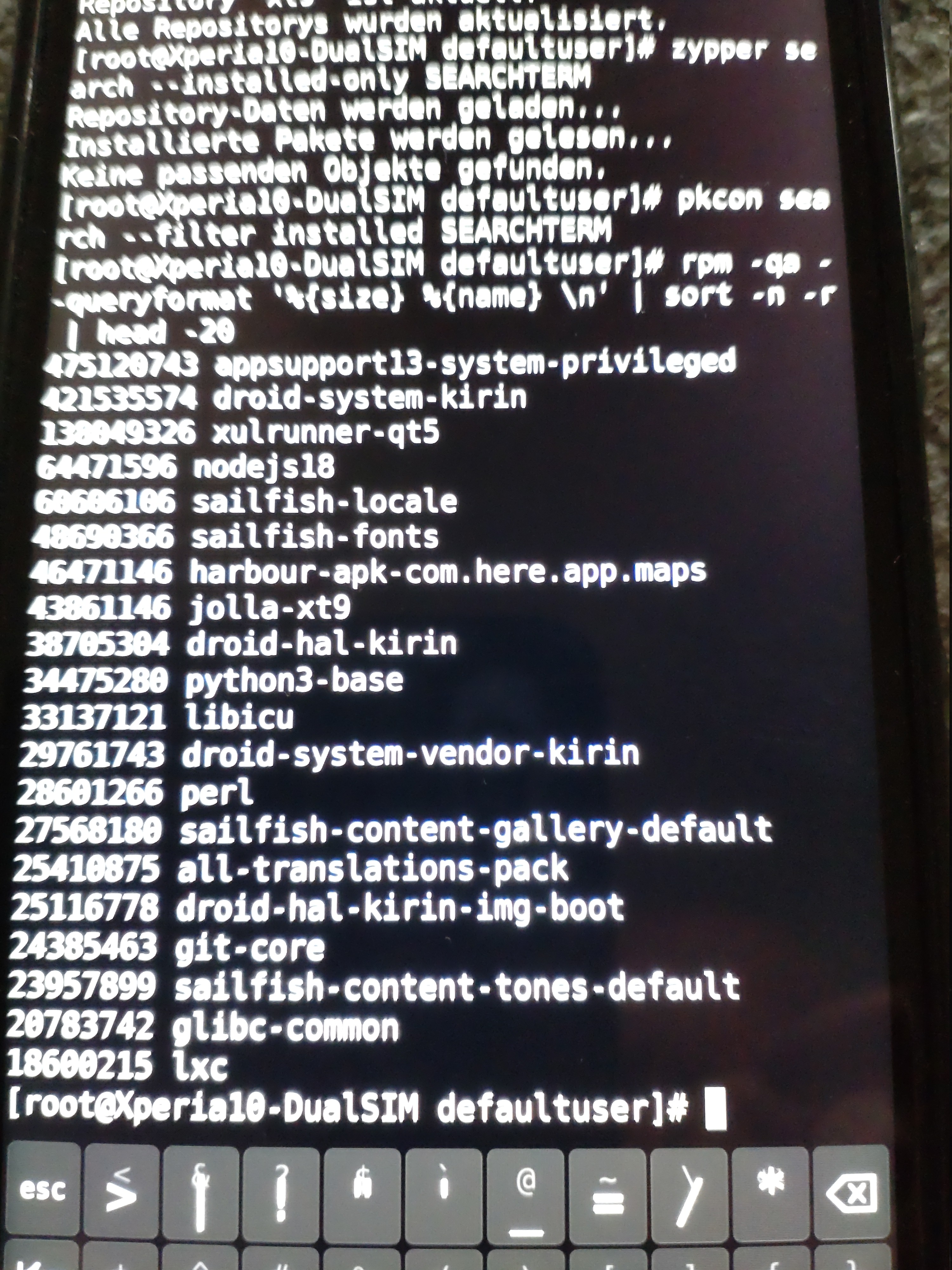

for shure a good guide, but to diffcult for me.
I think there is nothing I should uninstall from that list…
How about deinstall AAS? Would be a lot of work to install it afterwards to have it like it was.
