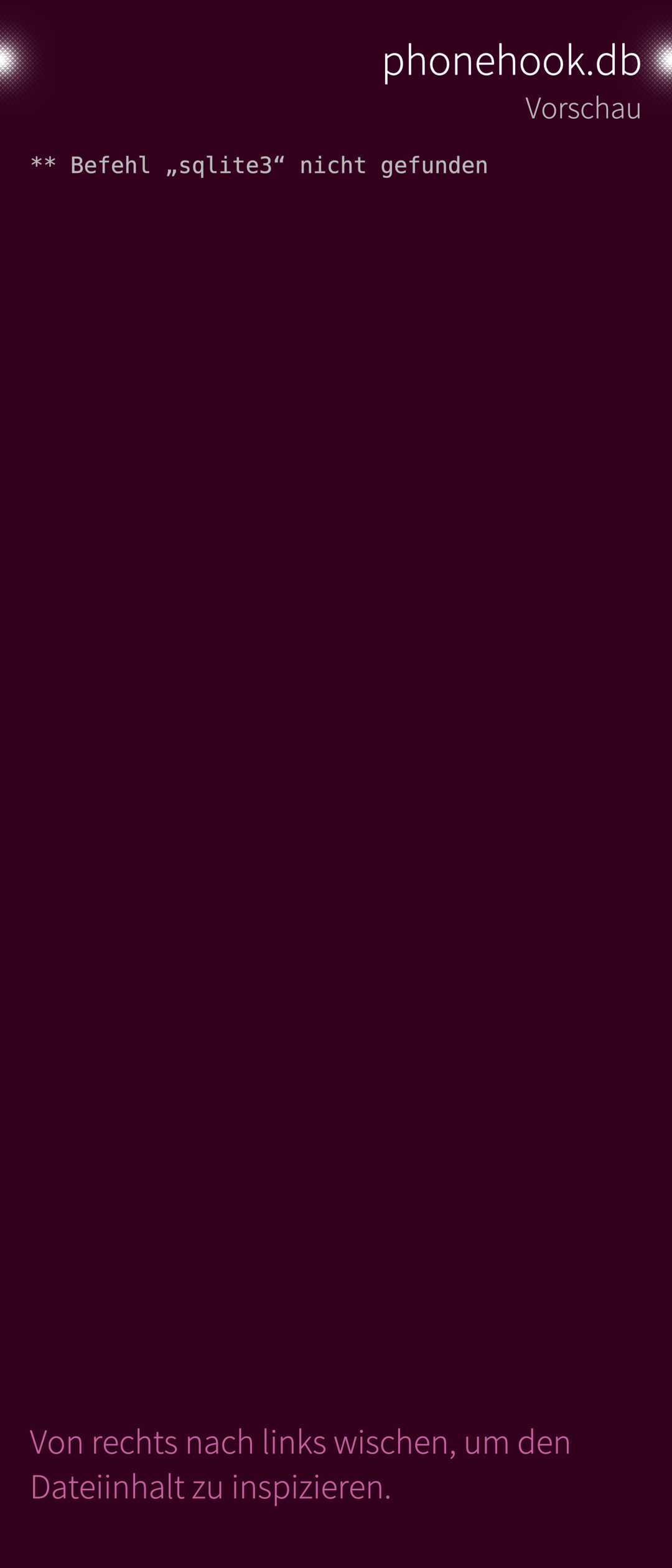

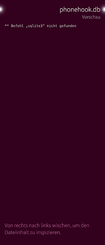

In
~/.phonehook/phonehook.db
there is now:
** Befehl "sqlite3" nicht gefunden
What does this mean?
precautionary I did install now ‘Kdb Sqlite3 Driver’ from Chum. Was this OK?
You mean the actual contents of that file are literally “** Befehl "sqlite3" nicht gefunden”?
How did you try to view it?
What do these commands say?
file ~/.phonehook/phonehook.db
type sqlite3
My XA2 has never been reflashed so it has all the good stuff, like
nemo, symlink defaultuser
~/.phonehook, symlink ~/.config/harbour-phonehook
(and working GPS but that’s not important right now)
When searching for packages that might be already installed, do something like
pkcon search name sql | grep nstall
(in Finnish grep senne).
yes.
checked the files content this way using File Browser:
The binary view of the file shows more senseful content, so I assume, there goes something wrong with the preview in File Browser.
edit: i’ve got the feeling that Phonehook works like intended, but got too less calls since installation to test in real life situations.
Oh, how could you make the hardware run? Did you follow the thread
pkcon has this built-in: pkcon search --filter installed sql
Yeah, so File Browser is being smart here - it detects that this is a SQLite database, and tries to show its contents using the tool that’s made for that: /usr/bin/sqlite3.
Thing is, that tool is not installed by default, and apparently not on your device.
If you pkcon install sqlite, the viewing in File Browser should work.
I did so and it works. Now the file’s content is visible. Thanks very much @nephros !
