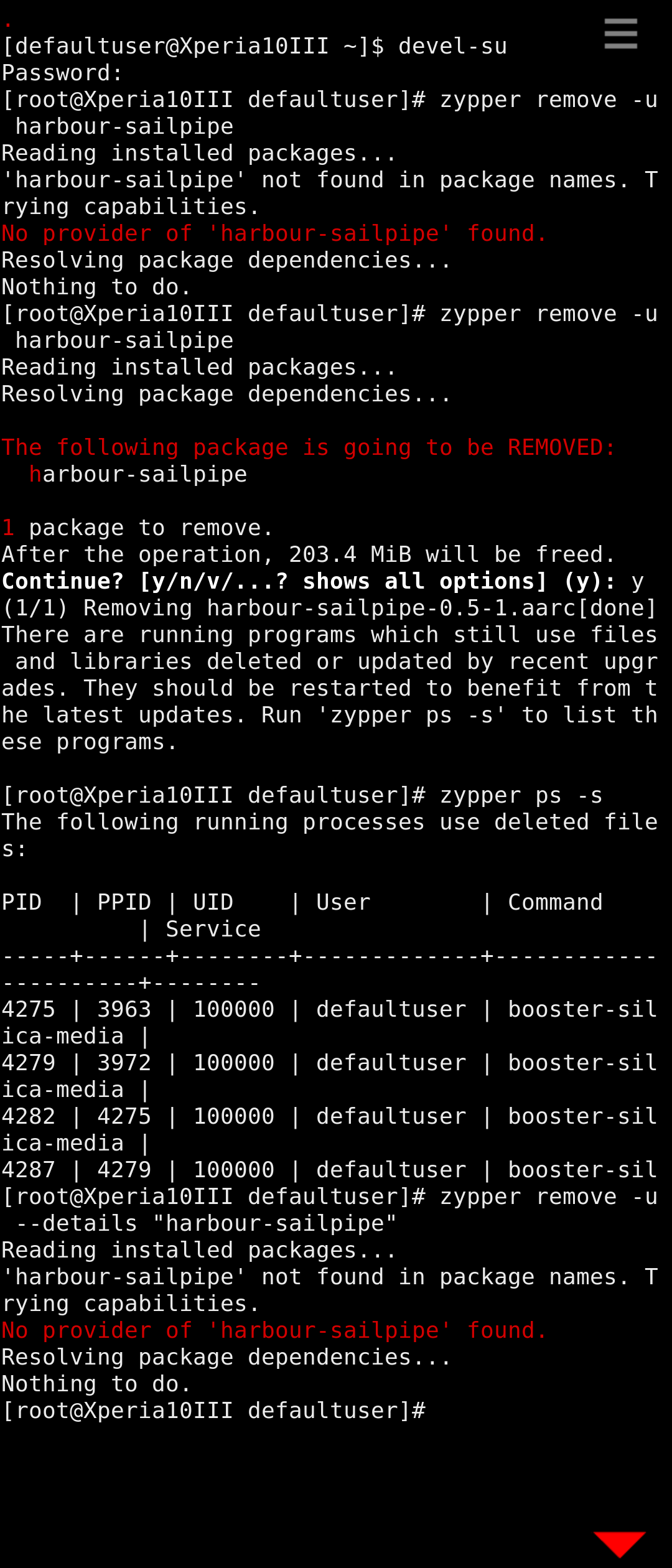

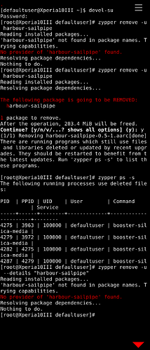

Invoking zypper
WARNING WARNING WARNING
Zypper will warn you if you try to uninstall critical packages.
If zypper says:
This request will break your system!
it means it.
Never ignore these warnings. Never choose ignore. Never use zypper --no-confirm.
Do use --dry-run if you’re not sure!
The general procedure is invoking zypper like this, replacing "[PACKAGENAME]" by the RPM package name (not necessarily the application name) to uninstall.
# become root
devel-su
# check what will be done
zypper remove -u --details --dry-run "[PACKAGENAME]"
# do it
zypper remove -u "[PACKAGENAME]"
Note the -u parameter, this will cause zypper to also uninstall dependencies which are not required any more.

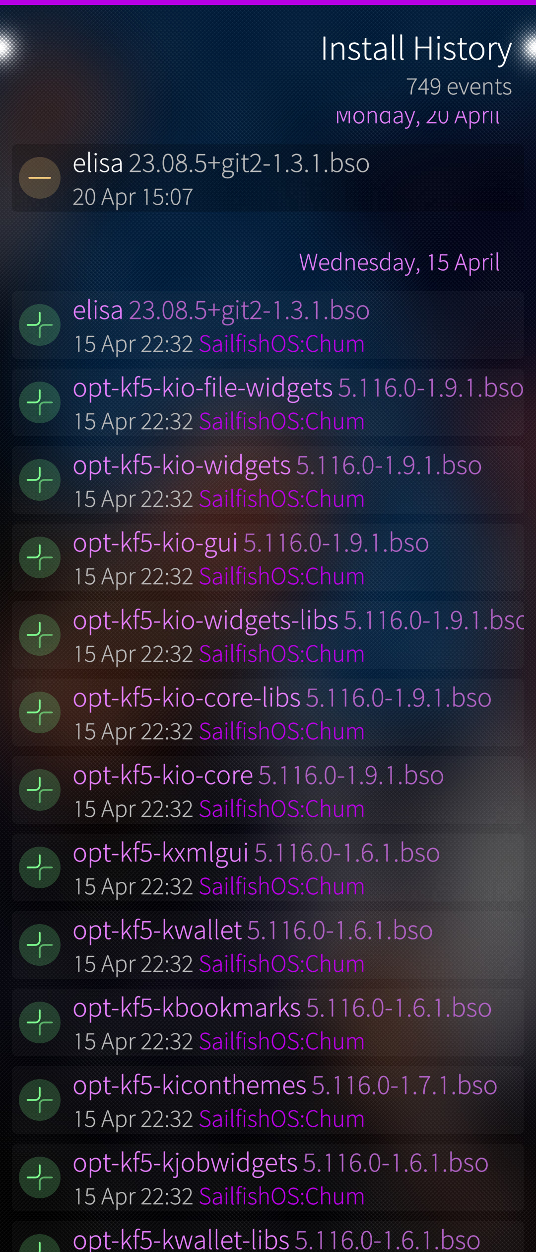

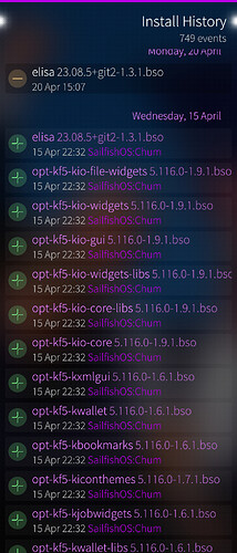

Package install/uninstall history
The package manager keeps a log of events at /var/log/zypp/history.
While that file is a little hard to read, it can be used to find out which packages were installed or uninstalled, whether that was successful, and when that happened.
Shameles Plug: this author’s app “Install History” can be used to make the file contents a bit more readable. And you get bar charts!

As I have uninstalled quite a lot of apps through UI, they for sure have left dependencies/caches/whatnot as in my root partition don’t have extra free space but the Mb usage has moved from under apps to “Sailfish OS and other files”. Is there somekind of command that could check and delete unused dependencies and caches? Or is that manual hunt? Sorry for stupid question, didn’t immediately find answer and I’m total linux noob
Well, as it sounds in here Removing Android AppSupport | Sailfish OS Documentation that you don’t loose your android apps if you uninstall AAS only and not the apps, this might be easiest way to proceed. Does anyone know, do you need to re-setup every android app after reinstall or would they work out of the box?
I’m not an expert in this matter, but why don’t you just extend the size of your root file system also to avoid having to go through the same tedious procedure time and time again? That’s what I did with my 10iii. By the way, does anyone know whether the default size of the root file system will be adequate in the J2?
I wanted to learn to use the terminal. I installed zypper as instructed. Then I tried to uninstall Sailpipe with this instruction:
# become root (well didn't do this as I was already root from installing zypper)
devel-su
zypper remove -u --details --dry-run "harbour-sailpipe"
# do it
zypper remove -u "harbour-sailpipe"
This gave me information that it will free ~200Mb and question if I wanted to continue y/n/v. I gave it y. It seemingly went through but it didn’t free the space in root partition. Then went and checked, it still showed in app grid. Went to openrepos/storeman, tried manually uninstall, got error package not found. Installed it again and no changes in memory usage in root partition. What did I do wrongly here?
I think --dry-run will ask you for confirmation, but then not actually do anything.
Try it again without --dry-run (the second line).
I think I was able this time to uninstall Sailpipe, but some Silica components use the files? Don’t really understand what this means, here is screenshot from the terminal
Aaand reboot seems to solve this one! Thanks @nephros <3

I’m afraid a huge part of leftovers is the fact neither uninstalling from app grid nor gui apps is actually using ‘–autoremove’ option of pkcon, so you will end up with a ton of random libs if you just install an app for a second to try, here’s example of install/uninstall elisa to see it working:
Good luck chasing all these smaller (not always) libs (there’s another page of installed libs below that screenshot), so proper cleanup would be, reinstall your uninstalled app, then ‘pkcon remove --autoremove’ it from cli
What’s the name of the app in your screenshot?
