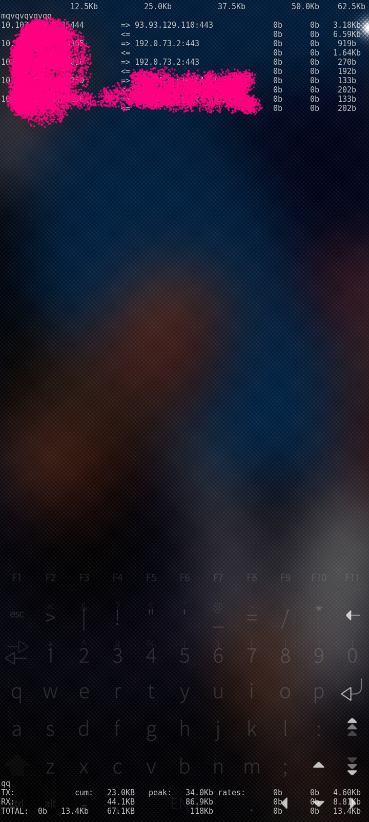

The app is great addition to nload/nethogs, realtime IP/hostnames of active connections, top for network:
but holy eff it was a pain to get built on-device, chum seems like an impossibility
