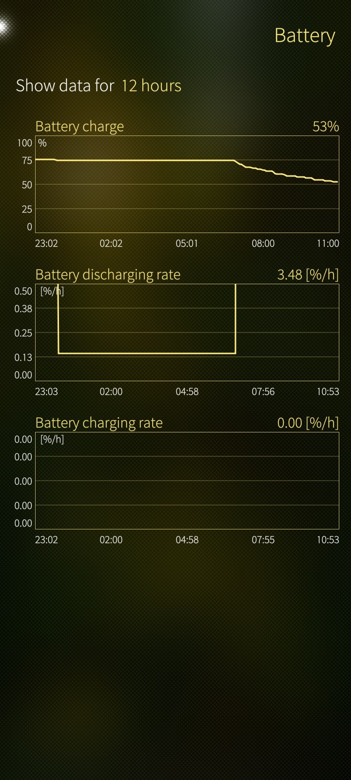

On my Jolla C2 typical 1,5-2 Days with heavy usage over the day (6-8h Radio-Stream with Bluetooth Headphone), Newspage readings 1-2h. Nighttime with Airplane-Mode on (~0,25%/h loss).
New record with 5.1.0.11 is 0,14%/h in flightmode, best before update was 0,19%/h.

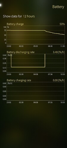

I got higher battery consumption last months, I tried also deactivating android support / wifi / bluetooth, restarted several times etc. For some years now I use Battery Buddy to set charging limits and see Current mA consumption and battery temorature. years ago, I was getting 120~140 mA. Last months it was never going under 270~290 mA. And the problem except battery lasts less time, it also is that the battery gets warmer! A couple of weeks now I noticed that when I put the phone in airoplane mode, the consumption goes down to 120-140 mA again, even with Android support running and wifi /bluetooth activated. The only change I did also some months ago is that in Mobile Network I activated 4G calling (VoLTE) (it shows registered). I did some tests and deactivated without seeing any difference.
The consumption also drops during when I set Airplane mode - I checked the diagrams with SysMon app.
