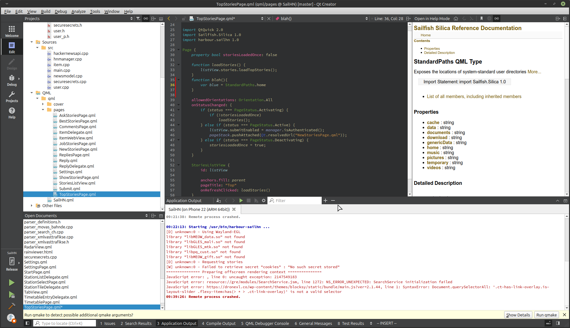

use the xdg support that’s built in. In qml:
property string imagePath: StandardPaths.PicturesLocation
also known as StandardPaths.pictures. I use this latter style mostly, which also works for documents, for instance.
AKA StandardPaths.standardLocations(StandardPaths.PicturesLocation)[0]

Huh, I couldn’t and still can’t find it anywhere in the documentation. But I see it is possible from other source code, like sailjail_test/qml/sailjailtest.qml at master · nephros/sailjail_test · GitHub
How could I have known I could use this? I clearly need some pointers in finding the correct documentation. Is it in Sailfish.Silica? I can only find qml object documentation for that.

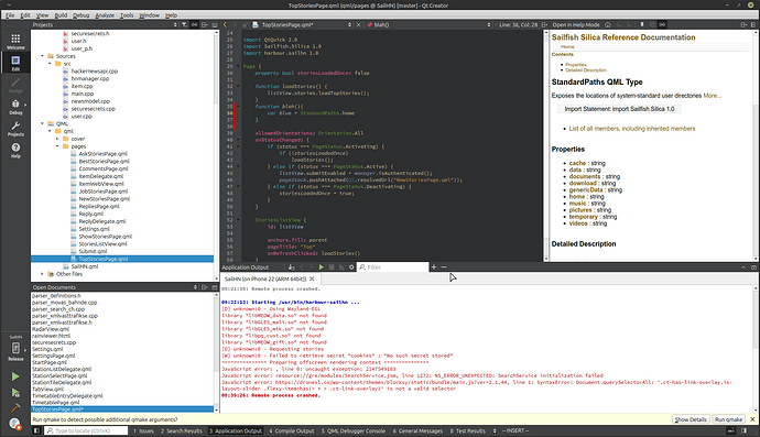

The source you quote from @nephros is right out of the docs: as I said,
is a short form. and StandardPaths.home is short for
StandardPaths.writableLocation(StandardPaths.HomeLocation)
EDIT. In the IDE, if editing a QML file, there is completion and context help (f1):
The way I look it up in the main documentation:
First find a path if it’s not in my head (rarely) get them from the c++ docs :
Then if I forget the ‘standard’ syntax for qml:
