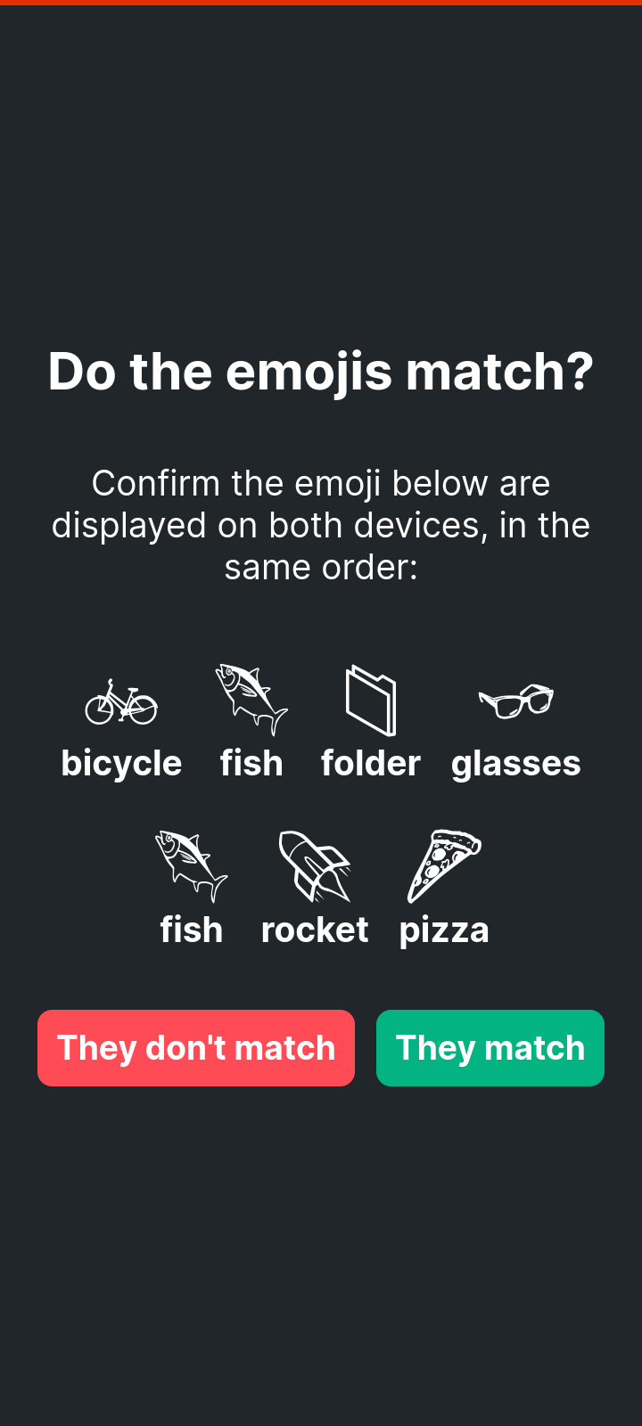

I am trying to work out how to verify my harbour-hydrogen session. I added the security code and I am able to read encrypted messages (written before first logging into that particular hydrogen session). So far, so good.
However, Element as well as nheko both keep telling me (nagging really) there is an unverified device and prompt me to verify it. Unfortunately, nothing ever happens on the Hydrogen side. I would expect the emojis to come up (or something at all), but there is nothing going on on that screen. Element used to have a text based verification where you’d just say ā€œyeah, that looks like my deviceā€, alas that’s gone. So, I am stuck. :pleading_face:
Do you have a suggestion on how to best verify a Hydrogen session?
So, I tried this all over again, deleting the org.github.hydrogen-sailfishos.harbour-hydrogen directory from .cache, .config and .local/share, logged in again and provided the security code. Alas, the outcome remained the same, i.e. the device remains unverified.
I’m on matrix.org and I assume this will turn into a major issue in October this year when they will start blocking unverified devices. (link) Will all Hydrogen users be left behind just because of this?
However, I am still hopeful that somebody might know of a way to verify a Hydrogen session. It has worked in the past somehow.
Does Hydrogen even support verification? I know Sailtrix does. Not sure whether I ever saw it on Hydrogen in the past.
How did you deal with this issue of verification? I always thought uploading the key ought to be enough. Apparently, it is not.

Thank you so much for looking into this. That’s an unexpected outcome, though. I had no problems logging Hydrogen into my matrix.org account. Actually, I successfully tried several time. I was also able to upload the security code. (To my mind, that final step should have prevented that session from being marked as unverified, alas I was wrong. :face_with_diagonal_mouth:)

Worked fine on 2nd attempt. Also the emoji verification with Element X.
Kudos and thanks a million for proving that this does work! :folded_hands: That’s a relief.

I deleted what I found, but have not gotten the emoji handshake window up again. Perhaps I need to remove the device at auth.matrix.org for that?
Also the loading the security key seems not to work, so I cannot decrypt previous messages.
Logging in first time on Hydrogen fails. Restarting the app and choosing my user account logs me successfully!
Ever since I received your response I have been trying to replicate that result by constantly logging in, testing something and out again (looking at the clock now that has taken quite a while for sure :flushed_face:).
Yes, I can confirm this weird phenomenon! So, dear future user reading this, please do not be frustrated by that first error message. Just restart. :index_pointing_up:
Second, before trying to verify the Hydrogen device, go to settings and enable cross-signing! That seems to be essential.
